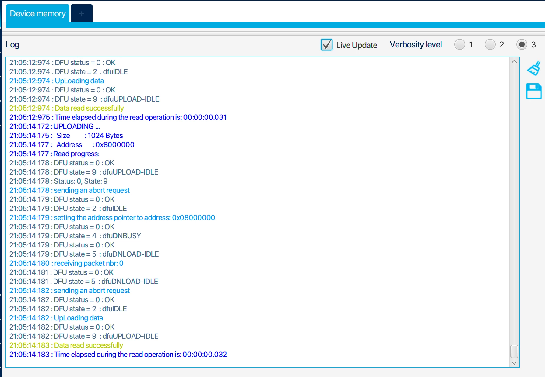

Hi all - I'm new to the STM ecosystem and I've been stuck on an STM32H743/ Micropython issue.
My (custom) board can upload Micropython firmware via both SWD and DFU. So DM/ DP work.
VCC measures 3.21V, maybe a little low, maybe just my DMM.
I'm not able to get this board to communicate over TX/ RX or see the board as a USB device.
The STM32H743 does not need series resistors on DP/DM and it has an internal pullup on DP.
I built a new Micropython firmware with (AFAIK) the correct settings/ pins for USB in mpconfigboard.h
-Do I need to configure the internal pullup? And how?
-What am I missing?
TL;Dr custom board w STM32, what does it need to run microPython?

I am still not able to get this board to show up as a MSC or communicate over UART.
Micropython is loaded into 0x08000000 and this address is verified with STM32CubeProgrammer.
I can use STM32CubeProgrammer only over ST-Link (SWD) or DFU. I'm not able to reach the chip's UART2 by TTL cable or Putty.
I've attached mpconfigboard.h configuration file with what I hoped was correct USB and UART settings.
The external crystal is 12 MHz. Power to the STM32H743 is 3.21V
Thanks in advance!
