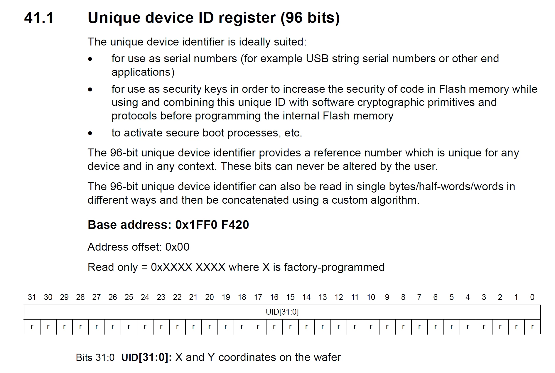

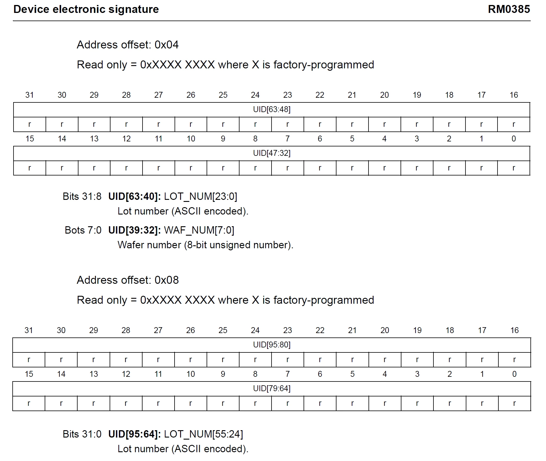

AStef.2
AStef.2Author
Aug 26, 2021 5:40 AM UTC
Dear TDK
Thank you for your reply.
First thank you for the description. I didn't understand it indeed.
After coding a readout I get for a board:
  • UID [0] 003F0043
  • UID [1] 5030500A
  • UID [2] 20333530
Except for X/Y coordinates that change for every chip, the same values across 16 and 18Mhz boards.
Wafer 48 of LOT P0P35 (hope I converted that correctly)
The coordinates however are quite close to each other as X or Y is sequential in the readings
16Mhz chips is Y 44,
18Mhz chips are Y 40,41,42,43 and so on
For the registers I've read the RCC
RCC_CR_HSICAL and RCC_CR_HSITRIM :grinning_face_with_sweat:
Not the RCC->CR my mistake, thank you for pointing it out .
HSITRIM shows the default value as expected
but HSICAL shows values that are consistent across "18Mhz" chips and different than the 16Mhz
Across all "18Mhz" chips I get :
RCC-CR 0x00007B83,
HSITRIM 0x10 default value for all boards.
HSICAL 0x7B (<- ??)
