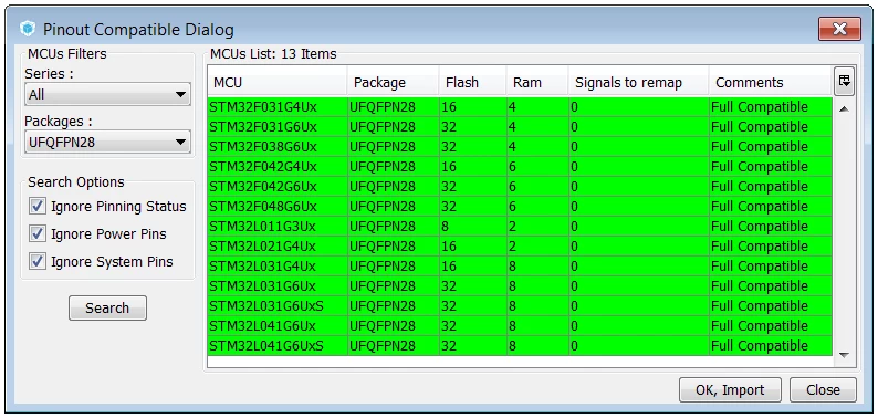

I m searching for a STM32L011G4 (16kb) compatible PIN to PIN mcu with memory>16kb. Is it exits ?

Hi @LMART.0​ ,
I agree with Clive's proposal. That is why I edited your post to add a title and a body.
Regarding your request: you can use STM32CubeMX:
  1. create a project with your device (STM32L011G4)
  2. go to pinout tab > List pinout compatible MCUs
==> you will get the list of compatible MCUs with details about the package, flash size and Ram size.

thanks Amel.​
