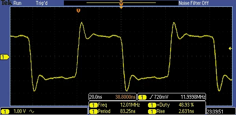

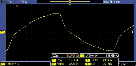

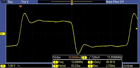

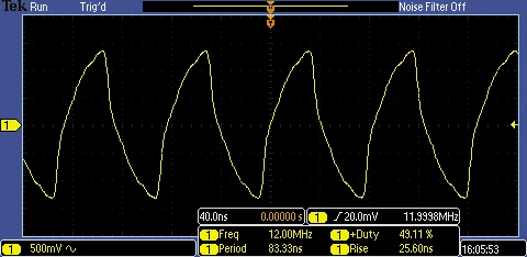

I have a MCBSTM32 board which uses the STM32F107 and includes a CS42L52 audio CODEC chip on board. I'm trying to create a 12 MHz clock input for the CODEC using TIM3 from the STM32. So far I have succeeded in generating the required 12MHz clock, but I'm not sure if it will work for the CODEC. The CODEC will accept smaller clock values (8KHz etc...) but I figured it was easier to only have to worry about one clock vs. several clocks.
I have attached screenshots of the output and wanted to get some feedback, as they don't look very pretty.  My thoughts are that I'm simply approaching the upper limits of the STM's clocking ability. As I understand it the 72MHz is simply multiplied from the real clock @ 25 MHz? In my code the system clock is set for 72MHz. Below is the timer setup code:

That does look pretty awful, like the loading is quite high. Try looking at another channel, not connected to the codec.
Personally I'd recommend using a PSC=0 for such a high output rate. (ARR=5, CCR=3)
Want to confirm the quality of the internal clock(s), export via the MCO pin.

Exactly correct in regards to the loading, had the probes set for 1x vs 10x! I did change the PSC like you recommended as well, seemed to be a little more stable than the settings I was using originally. Now I can finally to get to work on the codec part.
Thanks for the assist.
