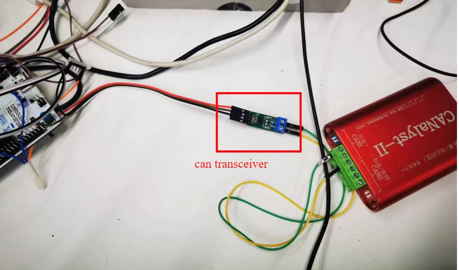

MB1549-U575ZIQ-C03 Board ,FDCAN don't work at FDCAN_MODE_NORMAL
board:MB1549-U575ZIQ-C03  (mcu stm32U575)
I debug the FDCNA function with a CANalyst tool
1. Work at FDCAN_MODE_BUS_MONITORING mode, It can receive data from the CANalyst tool
2. Work at FDCAN_MODE_EXTERNAL_LOOPBACK,It can receive data itself and the canslyst tool can receive the data
3. Work at FDCAN_MODE_NORMAL, It cann't receive data,and send data fail

mƎALLEm
April 17, 2024
  1. Are you using a transceiver with another CAN node connected to the bus?  if it's not the case it won't work.

dylanouAuthor
April 18, 2024
1. had can  transceiver

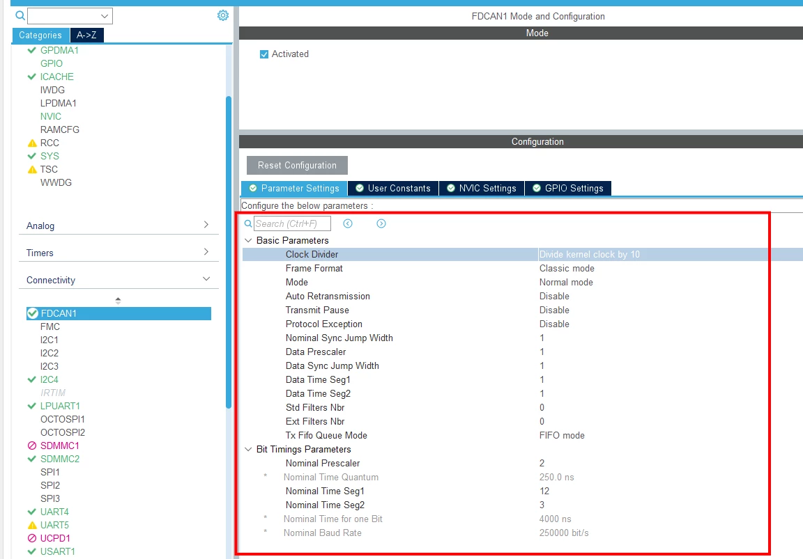

dylanouAuthor
April 18, 2024
I change below,but it doesn't work too
hfdcan1.Instance = FDCAN1;
hfdcan1.Init.ClockDivider = FDCAN_CLOCK_DIV10;
hfdcan1.Init.FrameFormat = FDCAN_FRAME_CLASSIC;
hfdcan1.Init.Mode = FDCAN_MODE_NORMAL;
hfdcan1.Init.AutoRetransmission = DISABLE;
hfdcan1.Init.TransmitPause = DISABLE;
hfdcan1.Init.ProtocolException = DISABLE;
hfdcan1.Init.NominalPrescaler = 2;
hfdcan1.Init.NominalSyncJumpWidth = 1;
hfdcan1.Init.NominalTimeSeg1 = 12;
hfdcan1.Init.NominalTimeSeg2 = 3;
hfdcan1.Init.DataPrescaler = 1;
hfdcan1.Init.DataSyncJumpWidth = 1;
hfdcan1.Init.DataTimeSeg1 = 1;
hfdcan1.Init.DataTimeSeg2 = 1;
hfdcan1.Init.StdFiltersNbr = 0;
hfdcan1.Init.ExtFiltersNbr = 0;
mƎALLEm
April 18, 2024
  1. had can transceiver -> Need to provide more details about your transceiver's module: the transceiver datasheet + module schematics as this is an important point for analysis.
  2. work at FDCAN_MODE_BUS_MONITORING or FDCAN_MODE_EXTERNAL_LOOPBACK ,It can receive or send data. -> Expected behavior if there is a HW issue (external from the MCU: wiring, transceiver issue, clock source, not the correct CAN pins assigned etc ..) the CAN won't work. Loopback and Monitoring are less restrictive.
  3. Need to monitor CAN_Rx (Not CAN_H nor CAN_L) with an oscilloscope or logic analyzer. Do you see CAN activity on CAN_Rx?
  4. You need also to share your project (at least the ioc file)

dylanouAuthorBest answer
April 19, 2024
Thand you for your reply
I find the cause of the problem
The transceiver need to power of 5V, but I only provide 3.3V
