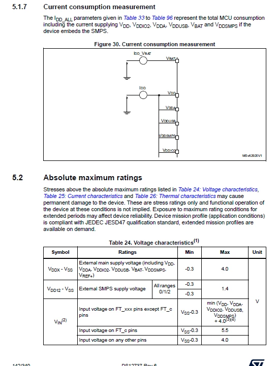

Hello, I am using a NUCLEO L552ZE-Q board, can some one please tell me what are the maximum and minimum voltages that it is safe to apply to an ADC input without causing damage to the Microcontroller.
Thanks in advance

https://www.st.com/resource/en/datasheet/stm32l552ze.pdf

Thanks Javier, that has answered my question.
