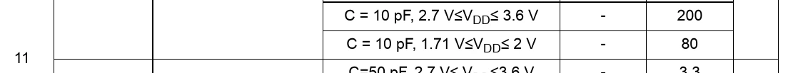

On H563 (same core) at 250MHz my test , just toggle a pin in a loop, shows 16ns loop time, so 62MHz are the max. possible toggle rate in software (doing nothing else ! 100% cpu load; highest pin speed setting and -O2.).
With hardware (mco, timer ...) output, you can reach 200MHz at low cap.load :
...from ds H503 .
