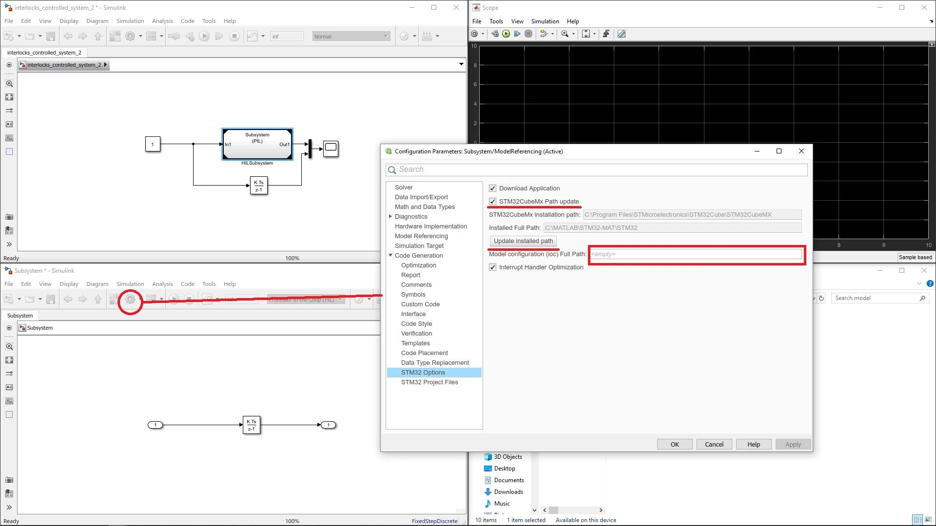

I am trying PIL in simulink with Nucleo board with stm32. But everytime there is error with crating some file. Does somebody has similar issues? What can be wrong? Simulink model I used is attached.
### Copy algorithms_test.ioc to X:\tmp\matlab_test\PIL_nucleo\Subsystem_PIL\Subsystem.ioc configuration file for PIL communication. ### Modify ioc configuration file for PIL communication. ### Open STM32CubeMX for configuration and project code generation.
Can not create file : Subsystem_PIL/.script

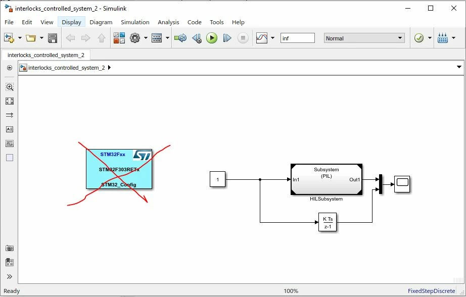

    You don't create .ioc file by yourself. The STM32-MAT/TARGET generate it automatically so you don't need MCU config block.

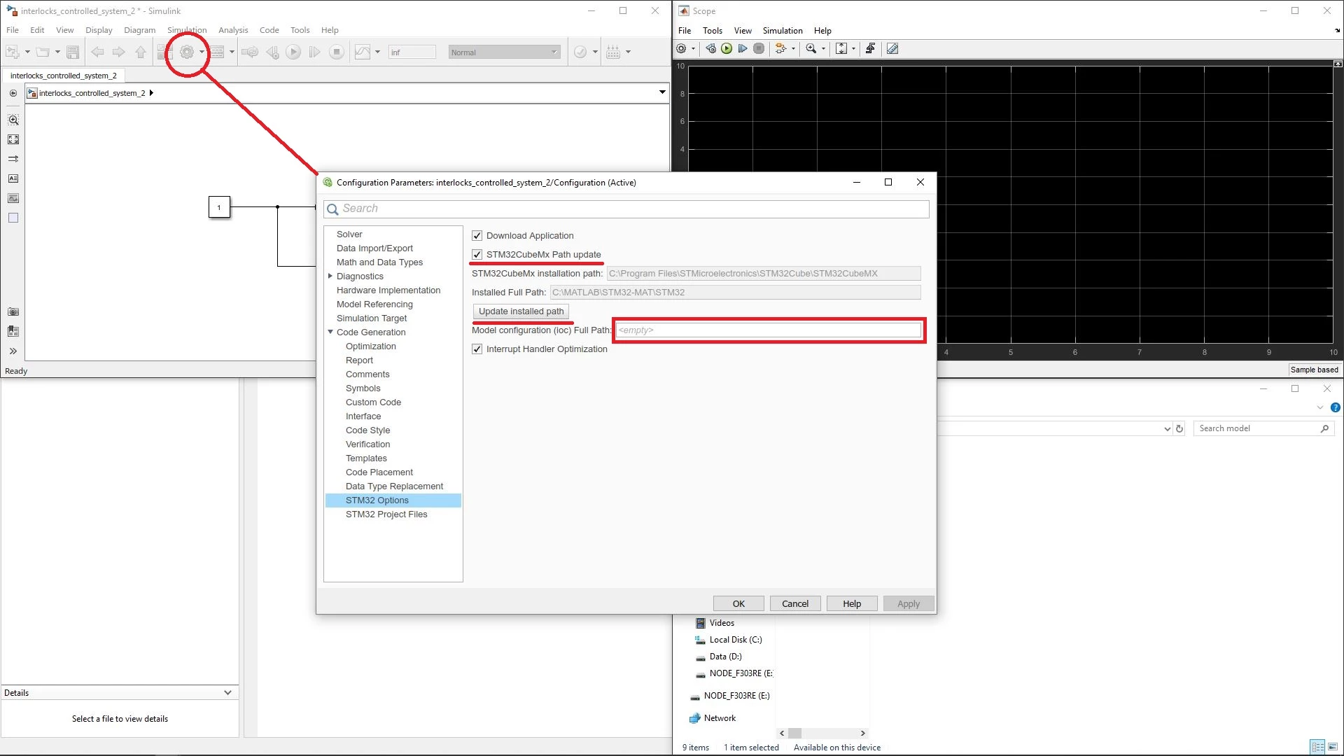

    Before build your project, please check Configuration Parameters setting of System and Subsystem as show in below picture.
    • Recheck STM32CubeMx Path update.
    • Click Update installed path.
    • Let's Model configuration(ioc) Full Path as empty.

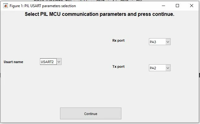

    I used EWARM toolchain and USART2 for communication.

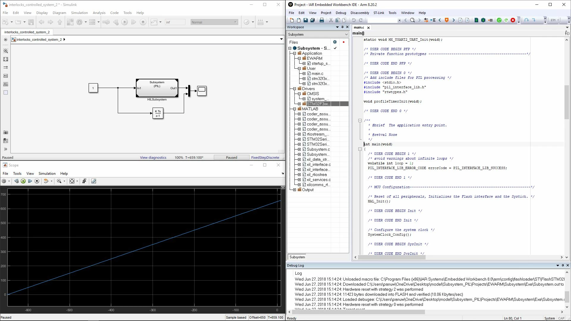

    And this is the result.
    Please check example in Hands on instruction again for more information.
