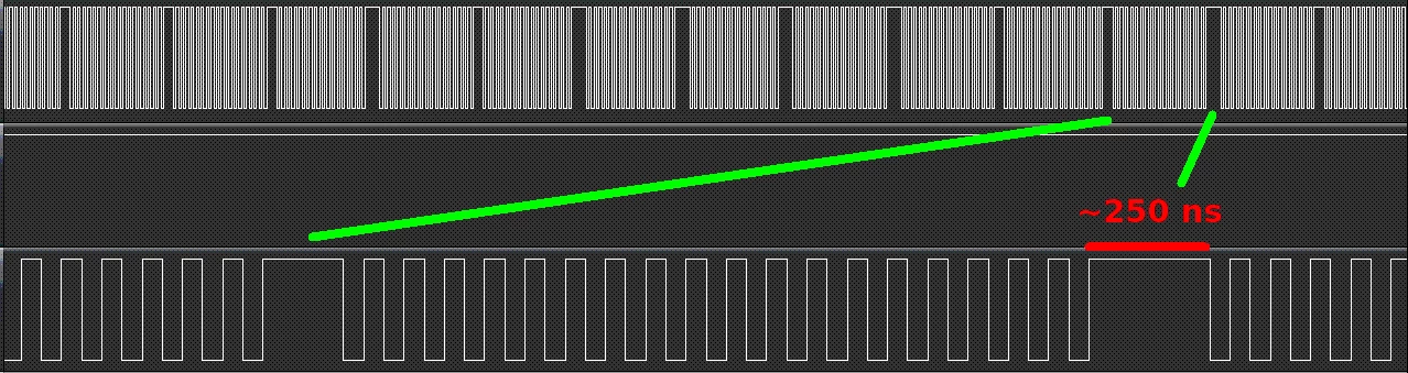

Hello.
MCU: STM32L432KC. I'm trying to use SAI1 peripheral in master mode with master clock (MCLK) generation. I've found MCLK has drop pulses. You can see this at attached picture.
Clock configuration:
1. LSE with crystal 32768 Hz;
2. MSI with PLLMODE enabled;
3. RCC registers values:
CR = 0x0C0000BF
ICSCR = 0x106F008C
CFGR = 0x0
PLLCFGR = 0x00001071
PLLSAI1CFGR = 0xA8012B00
CCIPR = 0x0
CSR = 0x1C000600
Is i missed something?
Thanks.

    The RCC settings indicate you want to output a clock at around 12.8MHz. The period of such is around 78ns, thus the duration of HIGH and LOW (if 1:1) is around 39us.
    If you sample them each 41.7us (that's the period at 24MHz), no wonder you miss some of the pulses here and there.

    Can't this be the root of problem? Can you try to switch off the PLLMODE or use some other primary clock source?

    Unfortunately, disabling 'MSI PLL Mode' does not help.

    And how are the SAI registers set?

    Also, what's the sampling frequency of the LA you are using, and what are its analog bandwidth limits?

    SAI registers:
    SAI1->GCR = 0x00000000
    SAI1_Block_A->CR1 = 0x00000040
    SAI1_Block_B->CR1 = 0x00010081
    SAI1_Block_A->CR2 = 0x00000000
    SAI1_Block_B->CR2 = 0x00000000
    SAI1_Block_A->FRCR = 0x00000007
    SAI1_Block_B->FRCR = 0x00050F1F
    SAI1_Block_A->SLOTR = 0x00000000
    SAI1_Block_B->SLOTR = 0xFFFF0140
    SAI1_Block_A->IMR = 0x00000000
    SAI1_Block_B->IMR = 0x00000000
    SAI1_Block_A->SR = 0x00000008
    SAI1_Block_B->SR = 0x00000000
    SAI1_Block_A->CLRFR = 0x00000000
    SAI1_Block_B->CLRFR = 0x00000000
    SAI1_Block_A->DR = 0x00000000
    SAI1_Block_B->DR = 0x00000000
    LA is the Saleae clone with SN74LVC2T45 level translators. Sample rate is 24 MHz. Unfortunately i don't know real bandwith of that device.

    Forgot to explain: i use MCU only as clock generator.

    it was sample rate problem. My superfault. Thanks all to advice.
