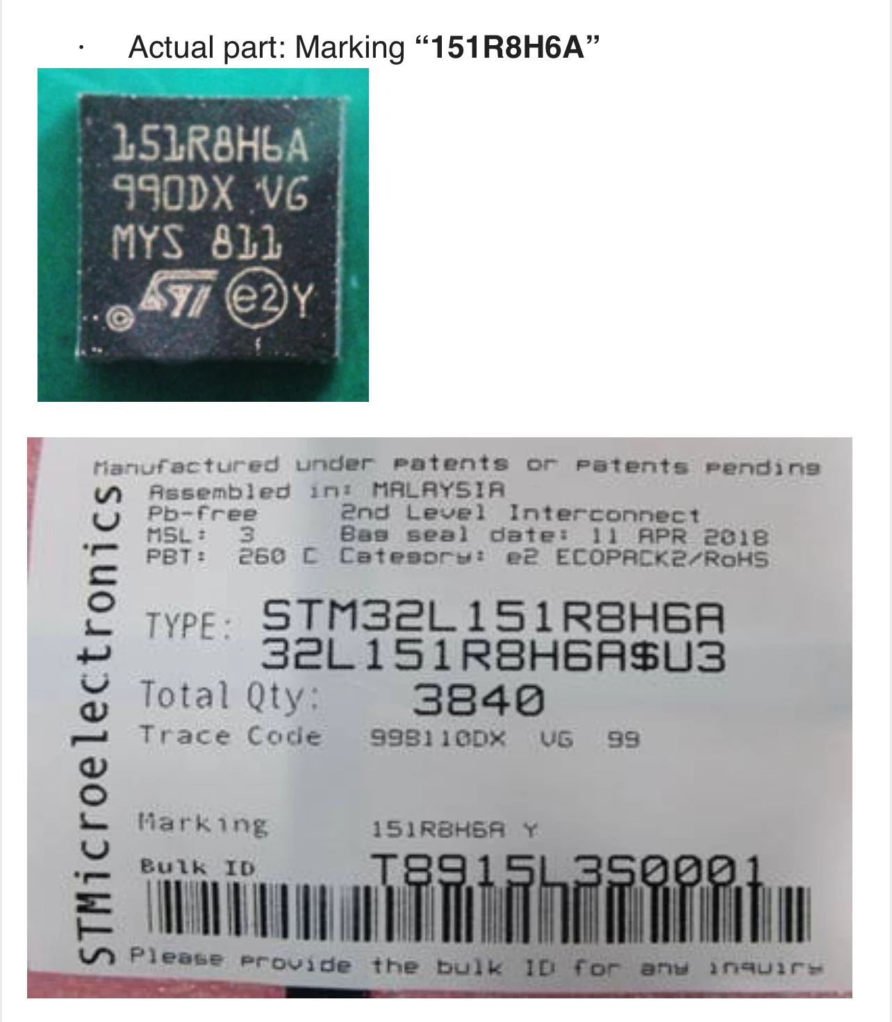

Marking on part STM32L151R8H6A mismatch with data sheet
Marking on actual part STM32L151R8H6A is “151R8H6A�? but data sheet is “L151R8H6A�?

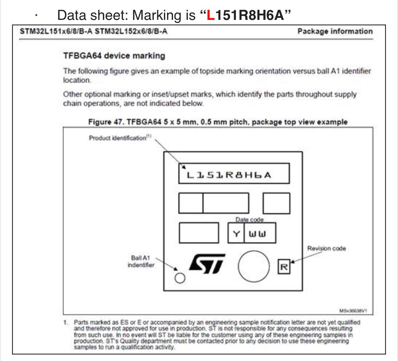

Welcome, @PWatt.2​, to the community!
Unfortunately there is a typo in the datasheet - the correct marking is 151R8H6A, i.e. without "L".
Good luck!
