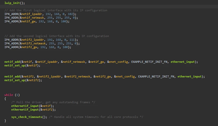

I'm attempting to bind multiple IP addresses to a single Ethernet port using different struct netif logical interfaces. My current implementation does not works for the both IP addresses
Seeking guidance or resources on the correct approach. Any insights appreciated.
Thanks,

Melgh.1
Melgh.1Author
February 6, 2024
in the world of Networking when one interface have more than one IP is called IP aliasing and is a very common practice
What do you mean by that?
  • Neither works?
  • only one works?
  • other??
Do you have it working with just one address?

Melgh.1
Melgh.1Author
February 6, 2024
Both are not working,
but one works if you deactivate one of them:
//ethernetif_input(&netif);
ethernetif_input(&netif_0);
 IP4_ADDR(&netif_ipaddr, configIP_ADDR0, configIP_ADDR1, configIP_ADDR2, configIP_ADDR3);
 IP4_ADDR(&netif_netmask, configNET_MASK0, configNET_MASK1, configNET_MASK2, configNET_MASK3);
 IP4_ADDR(&netif_gw, configGW_ADDR0, configGW_ADDR1, configGW_ADDR2, configGW_ADDR3);
 IP4_ADDR(&netif_ipaddr_0, configIP_ADDR0_0, configIP_ADDR1_0, configIP_ADDR2_0, configIP_ADDR3_0);
 IP4_ADDR(&netif_netmask_0, configNET_MASK0_0, configNET_MASK1_0, configNET_MASK2_0, configNET_MASK3_0);
 IP4_ADDR(&netif_gw_0, configGW_ADDR0_0, configGW_ADDR1_0, configGW_ADDR2_0, configGW_ADDR3_0);
 lwip_init();
 snmp_example_init();
 netif_add(&netif, &netif_ipaddr, &netif_netmask, &netif_gw, &enet_config, EXAMPLE_NETIF_INIT_FN, ethernet_input);
 netif_add(&netif_0, &netif_ipaddr_0, &netif_netmask_0, &netif_gw_0, &enet_config_0, EXAMPLE_NETIF_INIT_FN_0, ethernet_input);
 netif_set_default(&netif);
 netif_set_up(&netif);
 netif_set_default(&netif_0);
 netif_set_up(&netif_0);
 while (1)
 /* Poll the driver, get any outstanding frames */
 sys_check_timeouts(); /* Handle all system timeouts for all core protocols */

How many interfaces have you configured for?  By default the NetxDuo library defaults to 1.
