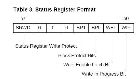

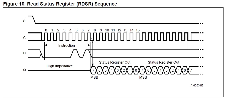

When I read RDSR data  is  0x0104
I don't know mean
0690X000006C0EjQAK.jpgWhen I see data sheet  RDSR is only 8 bit
But read 2 byte.

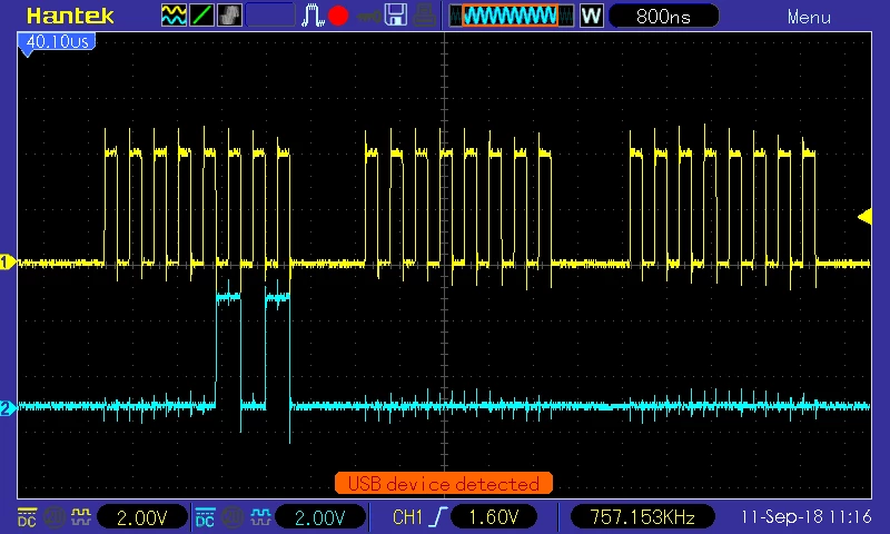

    You'll basically have to scope the pin, or use logic/protocol analyzer, and confirm the patterns seen on the pin to those reported by the STM32. You might have to review polarity/phase of clock.
    Sorry not using either of these parts.
    With PB3 you might want to make sure SWV functionality is not mapped on the pin, so check the SWD/JTAG remapping options in manual.

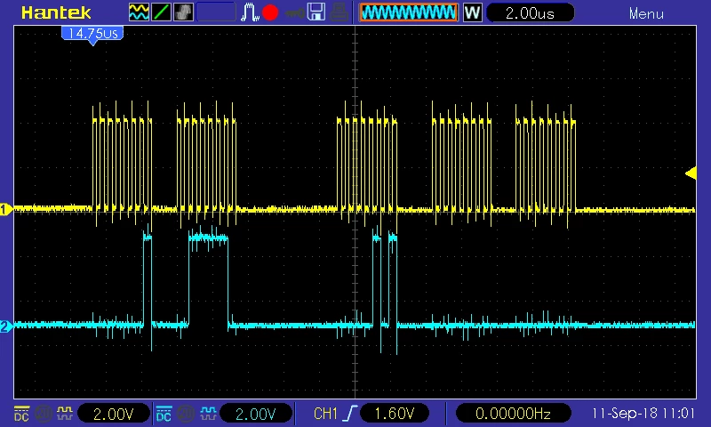

    MISO Pin  GPIO_Mode_AF_PP or GPIO_Mode_IN_FLOATING
    both  Work is Good.
    RDSR Read Data 0x02 0x02

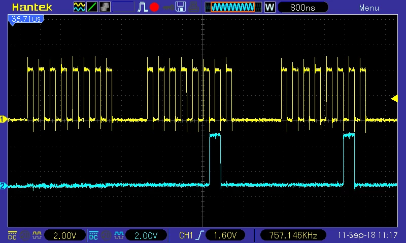

    ​now Just can Read RDSR
     while(1){
     M95512_WRDI(); //Write Disable
     Error = M95512_RDSR();
     delay_us(1);
     M95512_WREN(); //Write Enable
     delay_us(10);
    When I test .... Cand Read 0x00  0x00    and  0x02  0x02
    But Can't Read

    MOSI Signal Can work.
    But MISO Signal Can't work.
