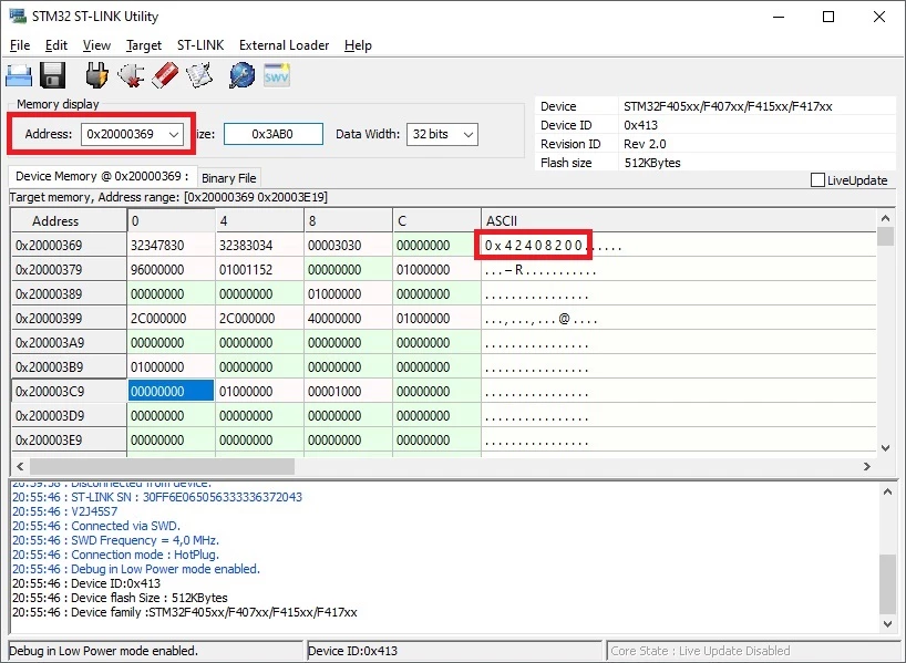

@DiBosco When I sometimes want to look to value I use my small function which convert data from R1 register to ASCII HEX string to buffer pointed in R0 register.
Declaration in C looks:
extern void my_htoa32(char * buf, uint32_t data);
But if you want invoke this from assembler you should to do:
 ldr r0, = 0x20000369 // for example a free area for use as buffer 11 bytes
 ldr r1, = 0x42408200 // value for tested
 BL my_htoa32
 lll:
 b lll // neverending loop

The result you can observe in STM32 Link Utility or in Cube Programmer:
