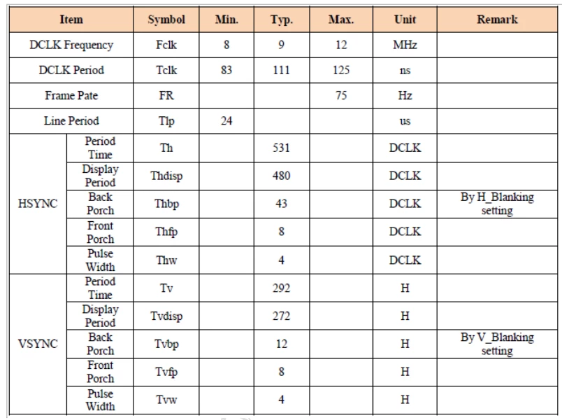

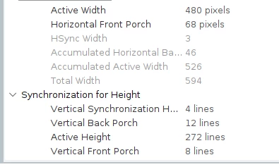

my RGB display does not have a buck boost converter nor a controller iC , so to give power i am using DC adapter with 12 v to enable backlight , and for data and clock i am using LTDC hardware in 16 bit mode. connections are made with jumber cables from my dev board to LCD , and when i turn it on   i am getting a black screen , and when i power off it turns white so that means LTDC may be working .  but i also have a framebuffer stored in external ram and that address is passed to LTDC so i should see some colors on the display but right now i am only seeing black screen.
LTDC timing and clock frequency are configured using this datasheet of my display .

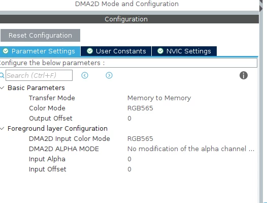

 also dma is too configured for this

DMA2D is here irelevant. Primary condition is external RAM is ok working. Better is make first testing in internal RAM. Use layer 0 windows 100x100 px and create framebuffer in internal ram... Set background colors not black for testing. Show here your layer config. For example RGB565 require setup right alpha nums.
