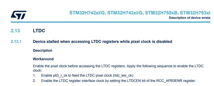

LTDC STM32H753 Debug crashes
wrote a basic test for ltdc and if i change any of the ltdc registers and pause the debug it crashes heres the functions for the ltdc ive wrote

Imen.DBest answer
Aug 28, 2024 1:56 PM UTC
Hello @Franksterb92
I think you encountered the limitation when accessing LTDC registers as described in the STM32H753 Errata sheet

Franksterb92
Senior
Sep 8, 2024 5:37 AM UTC
so would that just be setting the DIVR3EN Bit in the PLLCFGR to 1 to feed the pll3 to the ltdc if so i tried that and it does the same thing
Franksterb92
Senior
Sep 8, 2024 5:44 AM UTC
lol i see it now its in the rcc cr register i added
RCC->CR |= (1U<<28) to enable pll3
while(!(RCC->CR & (1U<<29){} to wait for pll3 ready
wow i feel dumb now it works for now thank you so much
