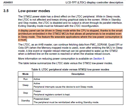

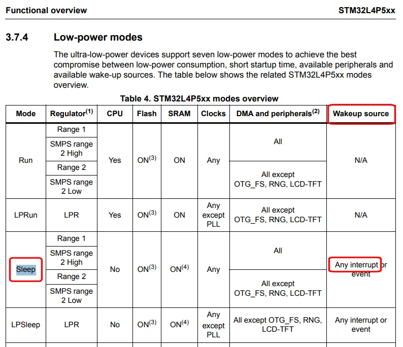

"Maybe it does enter sleep, but then there's an LTDC interrupt which immediately wakes it?"
My bad, I had to write "cpu doesn't remain in sleep".
LTDC interrupt, is a interrupt. I tought, by using "PWR_SLEEPENTRY_WFE", problem would be solved, but problem remained.
Are there any solution for my problem?

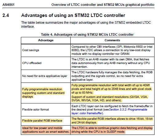

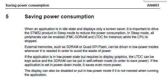

According to the following AN, it should be possible to enter sleep mode(and remain in sleep mode) while using LTDC.
Andrew Neil
June 10, 2025
Yes, but you need to ensure that it's not generating interrupts - because interrupts will wake the CPU...
