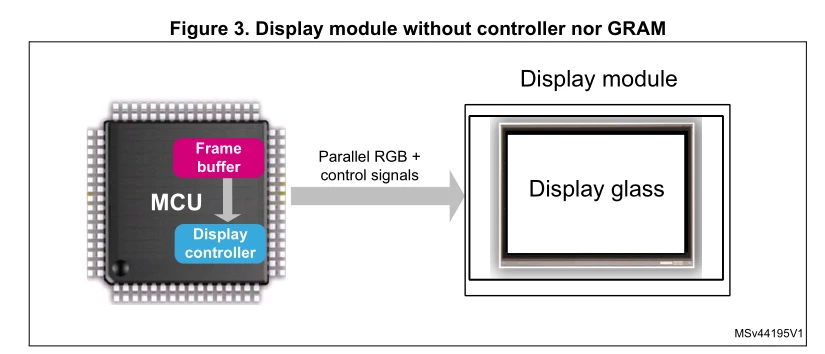

I'm currently working with the STM32F429IIT6 and using the LTDC to continuously output an image via parallel RGB + control signals. The image I'm trying to display is 854x480 pixels in 24-bit RGB888 format. The LTDC clock is running at 10.56 MHz.

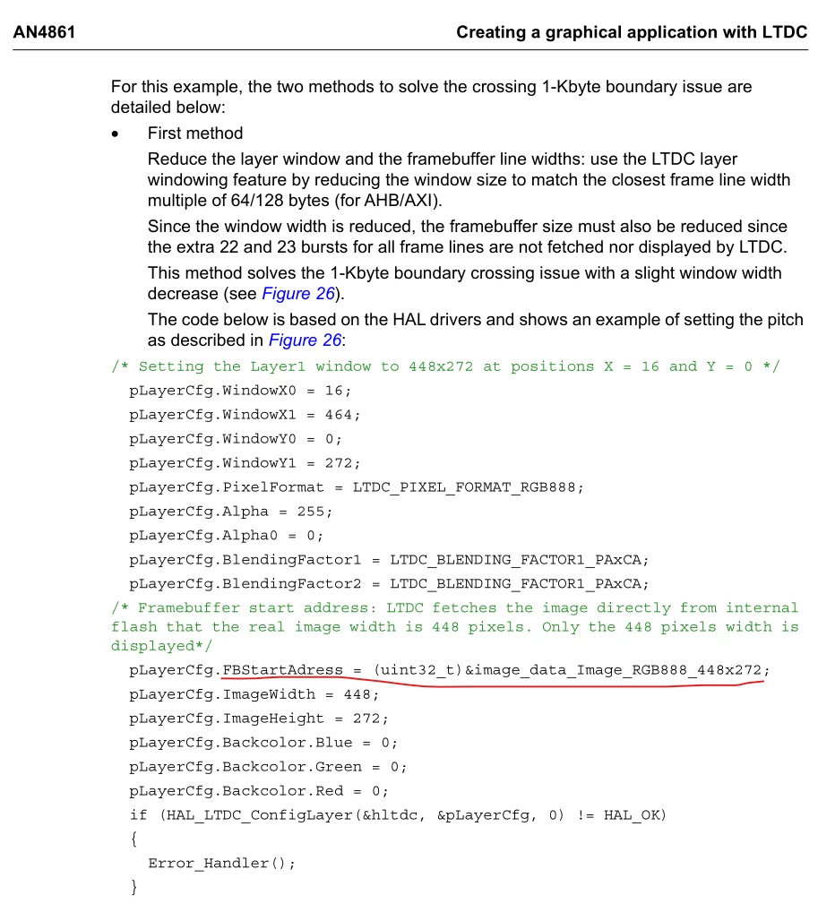

According to ST’s Application Note AN4861, I am using the internal frame buffer to send parallel RGB signals along with synchronization signals to the LCD. The total image size is:
854 x 480 x 24-bit = ~1.2 MB,
which fits comfortably within the STM32F429’s 2MB Flash memory.

However, the standard LTDC configuration in STM32Cube sets FBStartAddress to point to a full-frame buffer (854 x 480 x 24-bit). This results in a lot of redundant memory usage.
