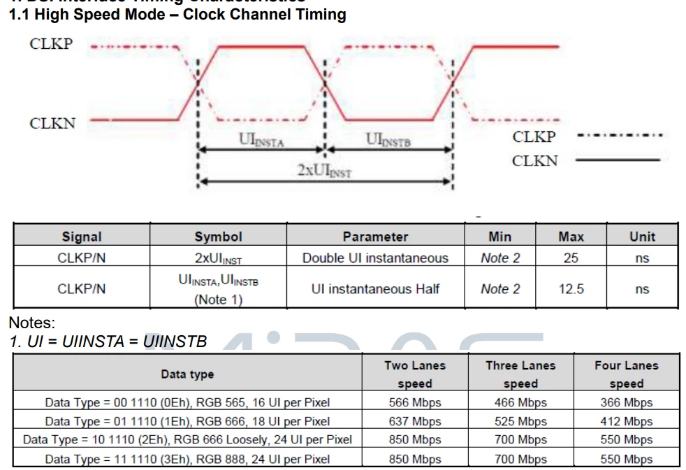

This is the datasheet for the panel I'm working on
It doesn't seem to say whether or not the panel itself supports 20Hz, but the PHY timings for the DSI link in my firmware all conform to what is laid out. I presume that if they didn't, I wouldn't be able to write the initialisation commands after power up and reset.
For 2-lane MIPI @ 24bpp, p9 of the datasheet specifies a UI time of between 1.176ns (850Mbps) and 25ns.

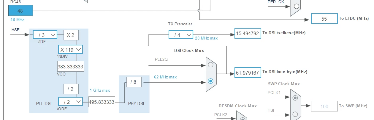

This is my current setup in the clock tree
By my calculations, a lane byte clock of approx 62MHz should give me a UI of approx 2ns, which fits this criteria.
Onto LTDC...

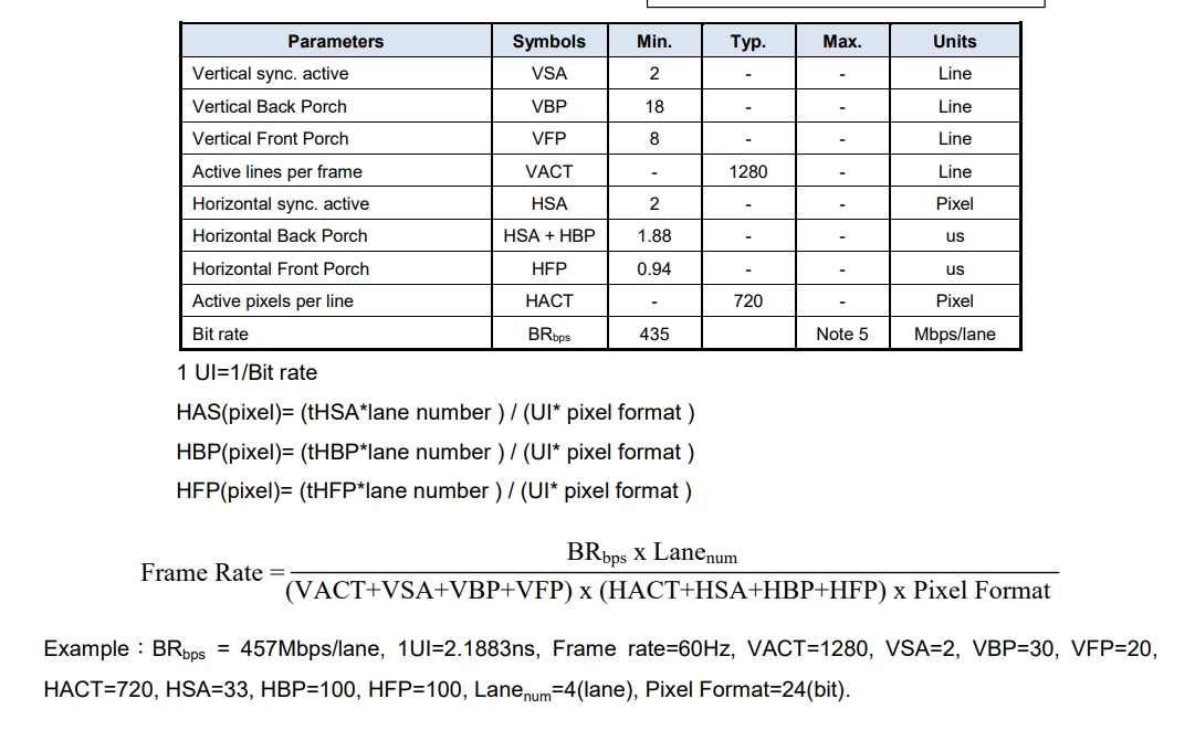

The example code given to me by the panel vendor puts the panel scan clock frequency at 55MHz. They are using an RA8776 graphics engine IC to drive the panel, with an SSD2828 MIPI bridge. In my setup, I see this as an analog for the LTDC and DSIHOST peripherals, respectively.
The datasheet for the panel itself doesn't give values for HBP,HFP etc., so I have reverse engineered it from the driver IC's datasheet and the example code:

Using the formulae from the ILI9881C datasheet and the porch timings, I have calculated the bandwidths and frame rates as follows:
BRbps = 496 (62MHz * 8)
LaneNo = 2
VACT = 1280
VSA = 2
VBP = 14
VFP = 8
HACT = 720
HSA = 2
HBP = 12
HFP = 18
Frame Rate = (492x10e6 * 2)/(1304*752*24) ~= 42fps
This all points towards the bandwidth for both DSI and LTDC being sufficient, particularly if I clock the LTDC lower to aim for 20fps. Am I missing something here?
