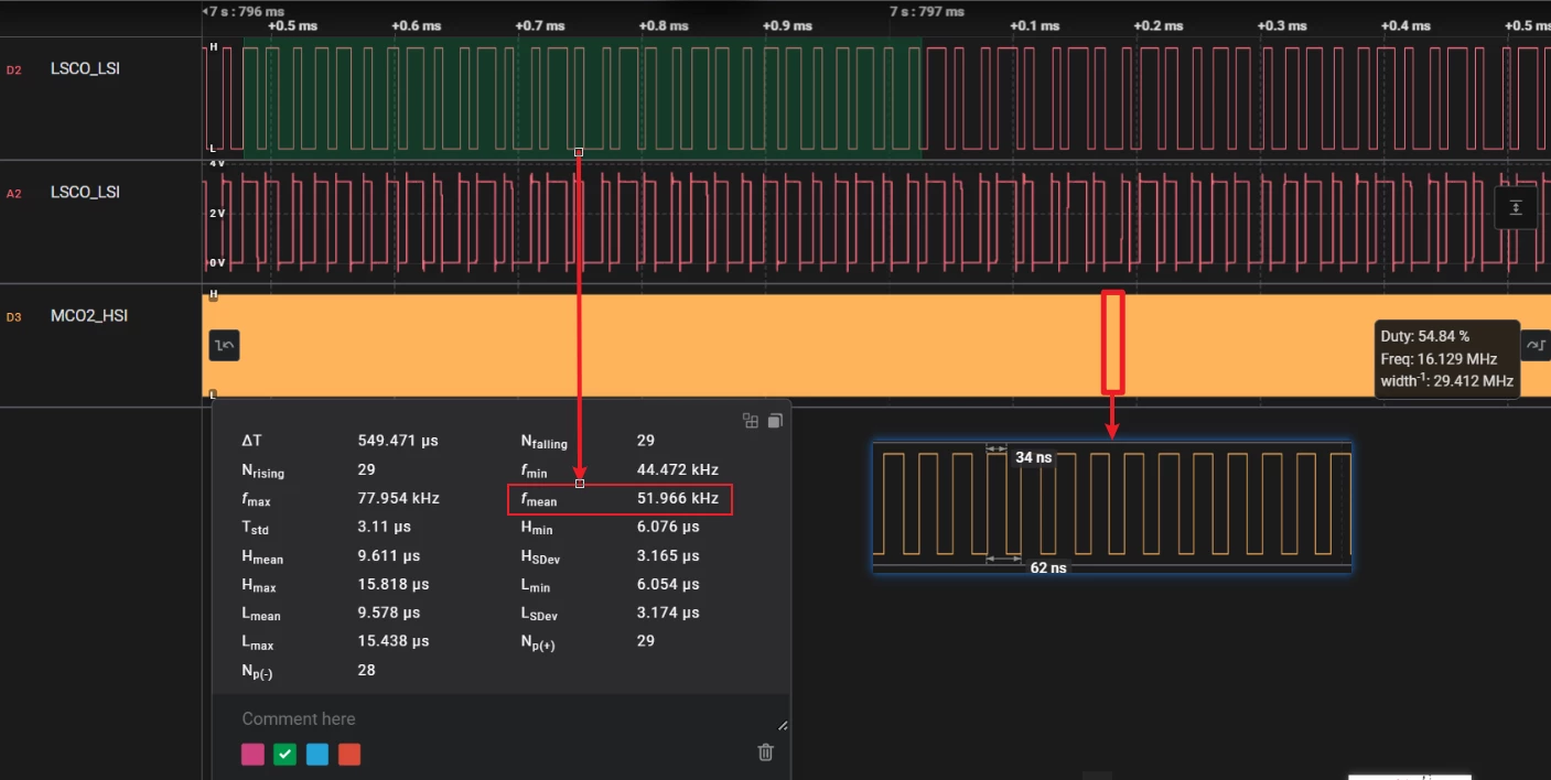

I'm working on a project using STM32U031, and using RTC with LSI(32kHz) to calculate elapsed time, and everything working fine, the waveform of LSI output also looks great.
And I need to switching power supply in sometimes, and there could happen the frequency of LSI become weird and average frequency change to ~52kHz, so i using LSCO and MCO2 to output the LSI and HSI, the HSI working fine when LSI abnormal, just like picture blow:
And here is my code to initial system clock which is copy from cubeMX:

when LSI is not stable, the problem could be slove by switch off power supply for few second to ensure the board is totally discharge. and power on, everything works perfect.
I'm not sure why this happed, and i can't keep this issue in final product.
Do i missed any configure or other? any suggestion to slove the problem?
