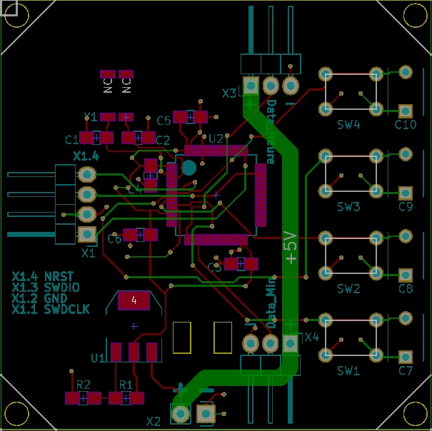

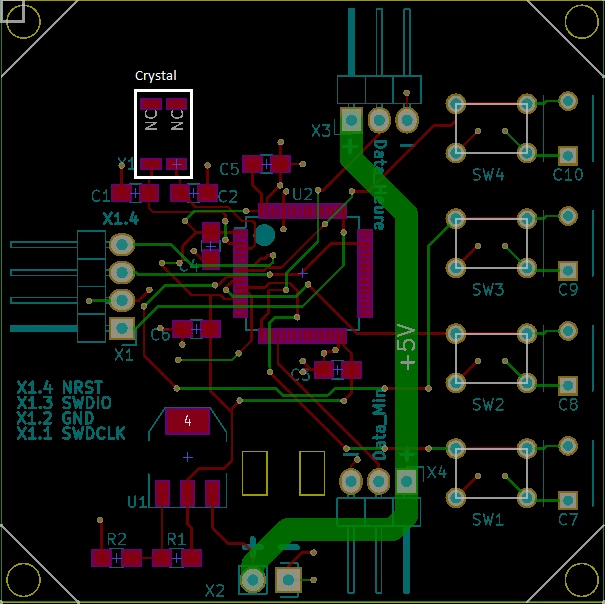

Post you PCB layout at aronud the crystal (or a photo).
Quentin Blanc
February 23, 2017
Posted on February 23, 2017 at 13:41
Here is the PCB layout as asked. If you need more just ask.

I don't like the 2 vias on OSC32_IN track and OSC32_OUT track seems too long to me.
You should start laying out your oscillator first to make sure the tracks are as short as possible.
But this is not bad enough to justify why your oscillator is not starting.
The EPSON MC-306 + 6pF capacitors is in the recommended listof
/external-link.jspa?url=http%3A%2F%2Fwww.st.com%2Fcontent%2Fccc%2Fresource%2Ftechnical%2Fdocument%2Fapplication_note%2Fc6%2Feb%2F5e%2F11%2Fe3%2F69%2F43%2Feb%2FCD002216pdf%2Ffiles%2FCD002216pdf%2Fjcr%3Acontent%2Ftranslations%2Fen.CD002216pdf
so it should be compatible
Are you sure you did solder the crystal is the right direction?

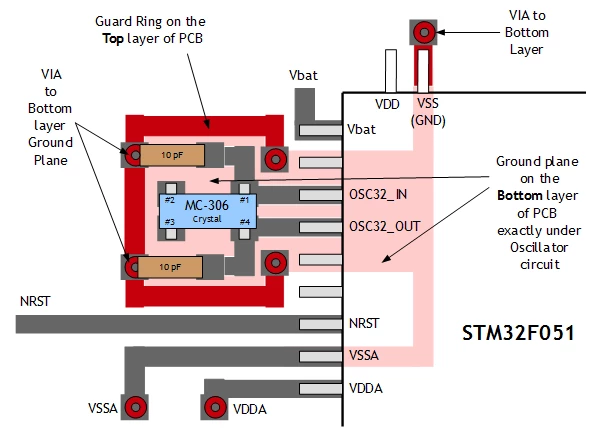

  1. Insted of a cylindrical DIP package of 32.768 kHz crystal, I used
    https://www.digikey.com/product-detail/en/EPSON/MC-306-32.768K-E3-ROHS/SER2417CT-ND/1532560
     along with two 10pF capacitors in 1206 SMD package as load capacitors CL1 and CL2

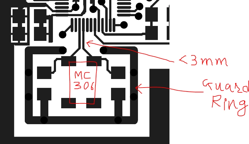

  2. Made sure that Crystal is mounted very very close (less than 3mm) to the microcontroller as shown below

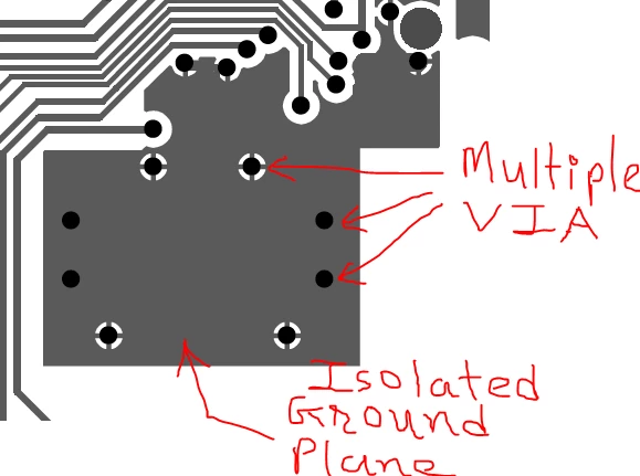

  3. Ocillator circuit has to be surrounded by a Guard Ring on the top layer of PCB, and by an isolated Ground Plane on the bottom layer of PCB as shown in below figure. The Guard Ring should be connected to underlying Ground Plane by multiple VIAs from top layer to the bottom layer.
  4. The Guard Ring and Ground Plane are to be connected only to the microcontroller ground and not to the rest of the circuit ground.
  5. Keep rest of the high frequency GPIO tracks away (more than 10mm) from the Oscillator circuit
  6. Keep the OSC32_IN and OSC32_OUT track of the same length and balanced
  7. Do not insert any test points on the tracks of oscillator circuit
Have a Look at my final PCB layout of Oscillator Circuit
TOP SIDE LAYOUT
BOTTOM SIDE LAYOUT
After applying above mentioned changes to a newly designed PCB, the LSE crystal started oscillating without any difficulties at all.
So my suggestion to you is to redesign the PCB keeping above points in mind.
I hope this helps you.
