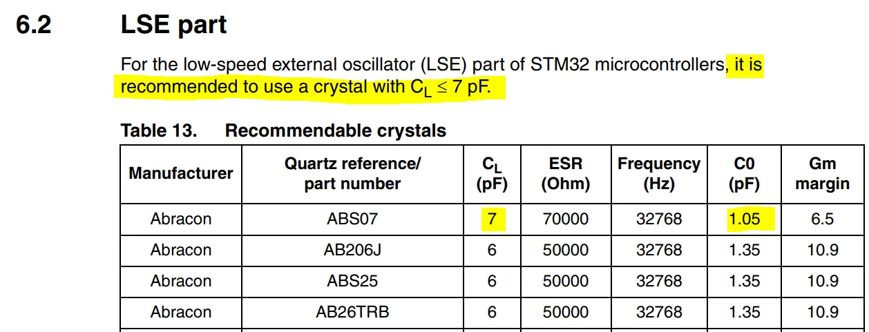

Hi, i'm trying to use the LSE clock with the RTC but it doesn't start until i make a state reset or run the code under debug mode.
I have read all other posts of LSE problems in the forum and found a lot of info, almost everything related with hardware or PCB layout, well, i have to admit that my pcb layout is not the best and the hardware parts either.
Hardware:
Schematic:
PCB layout:
The parts i’m using are:
Microcontroller: STM32L431VCT6
Crystal: https://www.digikey.com/products/en?keywords=631-1204-ND
Capacitors: 12pF as indicate the crystal datasheet.
Software:
The program do the next:
- Initialise all the clocks and peripheral (Including LSE and RTC)
- Enter while(1)
- After 3 seconds enter in STOP2 low consumption mode
- After 30 seconds wakes up with the “Wakeup�? interrupt from the RTC
Step 3 and 4 repeat periodical

}The program works well, but the problem is that the LSE don't start (the program get stuck) until a reset pulse or running the code under debugging. And if i power off and power on the board, the LSE get stuck again.
I tried almost everything, changed the LSE startup timeout, the drive capability, tried with different parallel resistors to the crystal, cleaning and drying the board.
I haven't tried changing the capacitors because i don't have any, but i can get some to try.
The problem happen in all the boards
So my questions are:
Why it’s only working after a reset and not on a power up?
It’s a software o hardware problem?
I have to change the crystal layout?
I have to change the crystal/caps parts?
