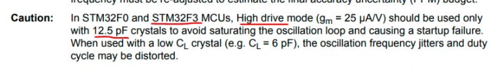

I have a STM32F373VBT MCU and I have issues with LSE.

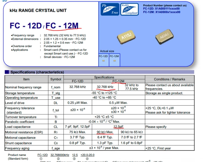

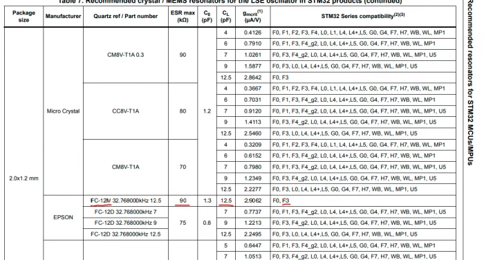

First I have selected this crystal.
0693W00000GY662QAD.pngBecause STM32 documention recomended it for my processor.
Also I notice that I need to have high drive for my crystal because it has a 12.5 pF load capacitance.

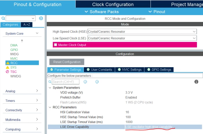

0693W00000GY68mQAD.png0693W00000GY5p2QAD.pngI enable high drive mode in CubeMX.

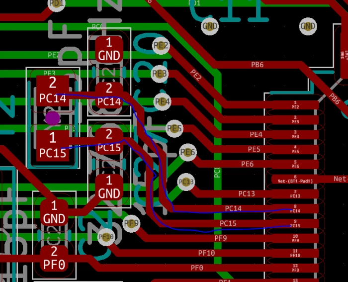

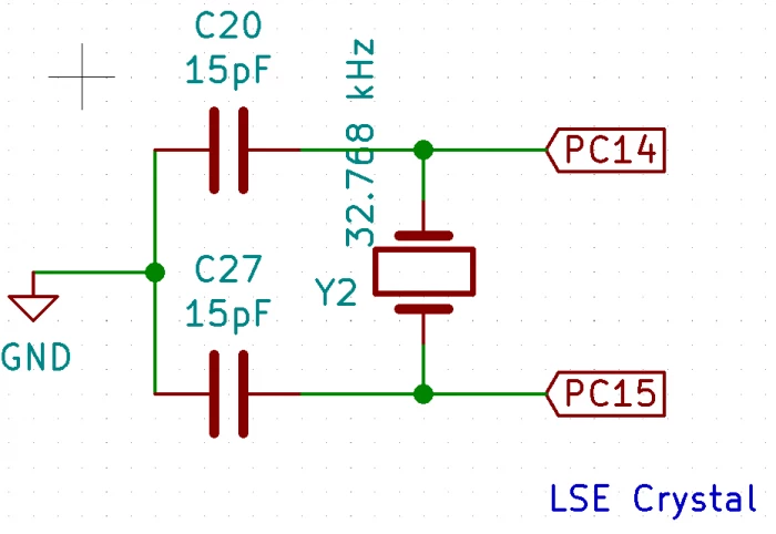

0693W00000GY69VQAT.pngHere is the layout where I placed the crystal and its capacitors. Each capacitor is 15 pF.

I have tried different type of capacitors:
  • 4.7 pF - Did not work
  • 15 pF - Did not work
  • 22 pF - Did not work

Crystals on the LSE are extremely sensitive to external signals. You have kindly enclosed the extract from the layout, in which no GND can be seen under the crystal, but a number of GPIO lines.
Please take a look at AN2867, Fig. 14 (PCB with separated GND plane and guard ring around the oscillator), which shows very nicely how the layout for crystals should be designed: there is a red guard ring around the crystal, which is connected with vias to the light blue GND island below. Please note that it is separated from the rest of the blue GND layer and is only connected centrally to the GND of the STM32. This GND island and the red guard ring form some kind of a "GND tub" looking like a "hand holding a stone", so to speak, in which the crystal and the two CL are located.
Additionally you should shorten the tracks between OSCIN/OSCOUT and the crystal as much as possible.

So in this case. I need to rewrite my PCB board and redraw as Fig. 14 shows? Nothing else I can do?

There are essentially two issues that can be addressed if the crystal does not oscillate correctly: hardware (layout and component parameters) and software.
While software and component parameters can usually be changed at any time without great effort, the board must also be changed to change the layout. So yes, at least you'd have to change the PCB.

PS: I hope there's a GND-plane between the top and the PCB layer with the green tracks...

  • Yes. There is a GND plane between the top and botton of the PCB. It's 4 layer board. GND/Signal -> GND -> Vcc -> GND/Signal. The GND and Signal is at the same layer.

If you want to measure oscillations at the LSE you have to use a low-capacitance oscilloscope probe (no more than 1pF input capacitance).
You didn't show the GND plane above, but that's not enough. As mentioned, the GND plane for the crystal must be separated and connected with its own connection directly to the GND pin of the STM32, NOT to a large, continuous GND plane between top and bottom.
