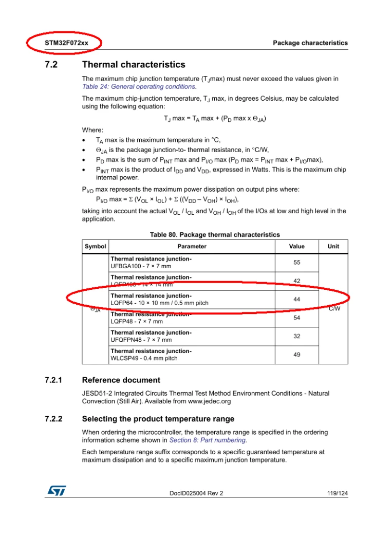

i would like to know what is the thermal resistance Rjc for a package LQFP-64. I didn't saw the value in the datasheet and i need it to know the Tj temperature, when PDmax is 0.1mW and my case is 90degrees.

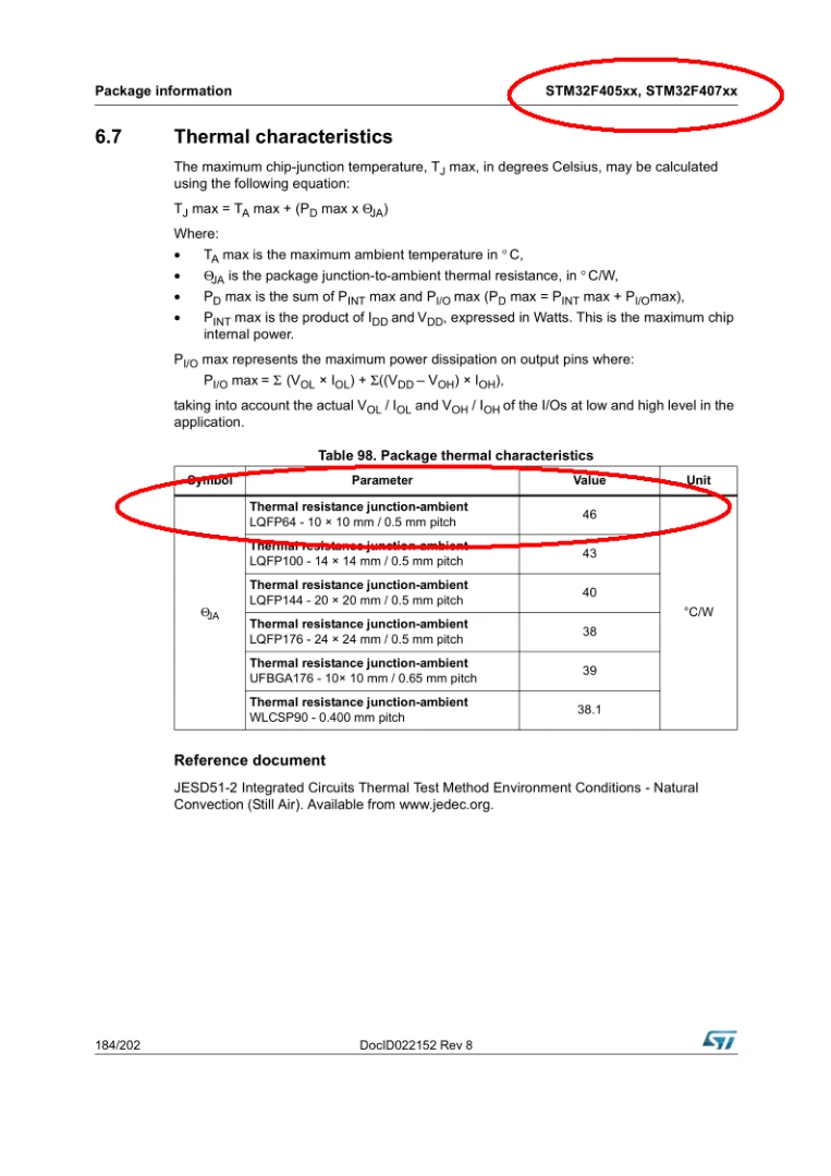

    waclawek.jan
    Sep 7, 2017 9:41 PM UTC
    Posted on September 07, 2017 at 21:41
    ST spreads or hides chip temperature data in many documents, it is difficult to find exact figures
    I didn't find it particularly difficult to find; it's simply in the DS for the given model. Not that surprisingly, it's (slightly) dependent on particularities of each chip, not just the package itself. Two randomly selected examples:
