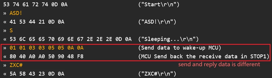

Hello everyone:
I'm working with board NUCLEO-U031R8, and need to wake up when LPUART receive data which using LSE with 32768Hz.
MCU would send back the receive data which end with '\n', and it works fine in running mode, and a special command 'S' let MCU go into stop mode and wait next data, and send back receive data when wakeup.
The receive data length is correct while wakeup in stop mode, but the receive data is broken, and if has next command it will reply as normal, the communication like this:
And here is the sample code:

 Anyone have any idea what's going on?

I found another solution is using HSI instead LSE, it makes everything goes fine, and current consumption is even lower than using an active LSE. So I decided to use HSI as the clock source for LPUART for now.
And I would like to clarify a few questions:
  • When environment temperature is very low or high, can I expect the tolerance of HSI to remain within 2%? I'm concerned that a significant deviation could lead to communication failures.
  • Just out of curiosity, why there is a LPUART receiving problem when using LSE? maybe just a hardware issue with LSE crystal or others?
