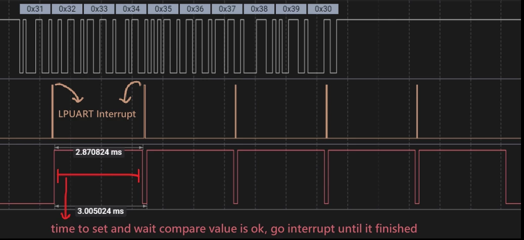

I'm using Board NUCLEO-U031R8 for testing now, and I started with cubeMX and initial component below:
  • System Clock configure to HSI (16MHz)
  • FreeRTOS with USE_TICKLESS_IDLE as 1 (built in functionality enabled), and auto generated two function PreSleepProcessing() / PostSleepProcessing().
  • LPTIM1 with 32kHz LSI and clock presclaer set to Div32, every timer count alomost 1ms, using for replace the sysTick while tickless idle.
  • LPUART1 with 16MHz HSI1, interrupt RXNE/WKUP/ERROR always enabled after system initial done.
The task is startup and print information and delay 1 second, then entering an endless loop that includes a 1-second running delay and a 4-second sleep delay, and everything works fine in 1 second running delay.

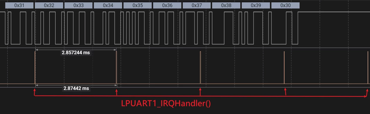

But when sending bytes in sleep, it would occur overrun error when received length > 2, so i toggle an output while interrupt occur. and i saw an weird interrupt while receiving bytes, the record here.
To I modify tickless idle part, I disable sysTick and start LPTIM then go stop1 mode in PreSleepProcessing(), and  restore everything and call vTaskStepTick() in the end of PostSleepProcessing(), and commit out the vTaskStepTick() in vPortSuppressTicksAndSleep() of port.c

LPUART IRQHandler:

keinAuthor
October 4, 2024
i think i found the problem, the time to set CCR1 and wait CMP1OK of LPTIM is too long (2~3ms), it makes in the waiting time not trigger the interrupt until whole function finish, just like this:
my next step is to found out if there is any peripherals which can replace LPTIM.
and here is the timer code
void LPTIM_Start(uint32_t timeout) {
 static bool initialed = false;
 if (initialed == false) {
 LL_LPTIM_EnableTimeout(LPTIM1);
 LL_LPTIM_Enable(LPTIM1);
 LL_LPTIM_ClearFlag_DIEROK(LPTIM1);
 LL_LPTIM_EnableIT_CC1(LPTIM1);
 initialed = true;
 LL_LPTIM_ClearFlag_CMP1OK(LPTIM1);
 LL_LPTIM_OC_SetCompareCH1(LPTIM1, timeout - 1);
 LL_GPIO_SetOutputPin(OUT2_GPIO, OUT2_PIN); // OUT2 pin using for debugging
 // NOTE: wait here until the APB bus write operation to the LPTIM1 CCR1 register has been successfully completed, it takes around 2~3ms and the interrupt would not triggered immediatly.
 while (!LL_LPTIM_IsActiveFlag_CMP1OK(LPTIM1));
 LL_GPIO_ResetOutputPin(OUT2_GPIO, OUT2_PIN);
 LL_LPTIM_ResetCounter(LPTIM1);
 LL_LPTIM_StartCounter(LPTIM1, LL_LPTIM_OPERATING_MODE_ONESHOT);
void LPTIM_Stop(void) {
 // only clear the flag, let LPTIM keep enable.
 LL_LPTIM_ClearFlag_CC1(LPTIM1);
If there are any mistakes, please correct me, and welcom any suggtion and advice.
