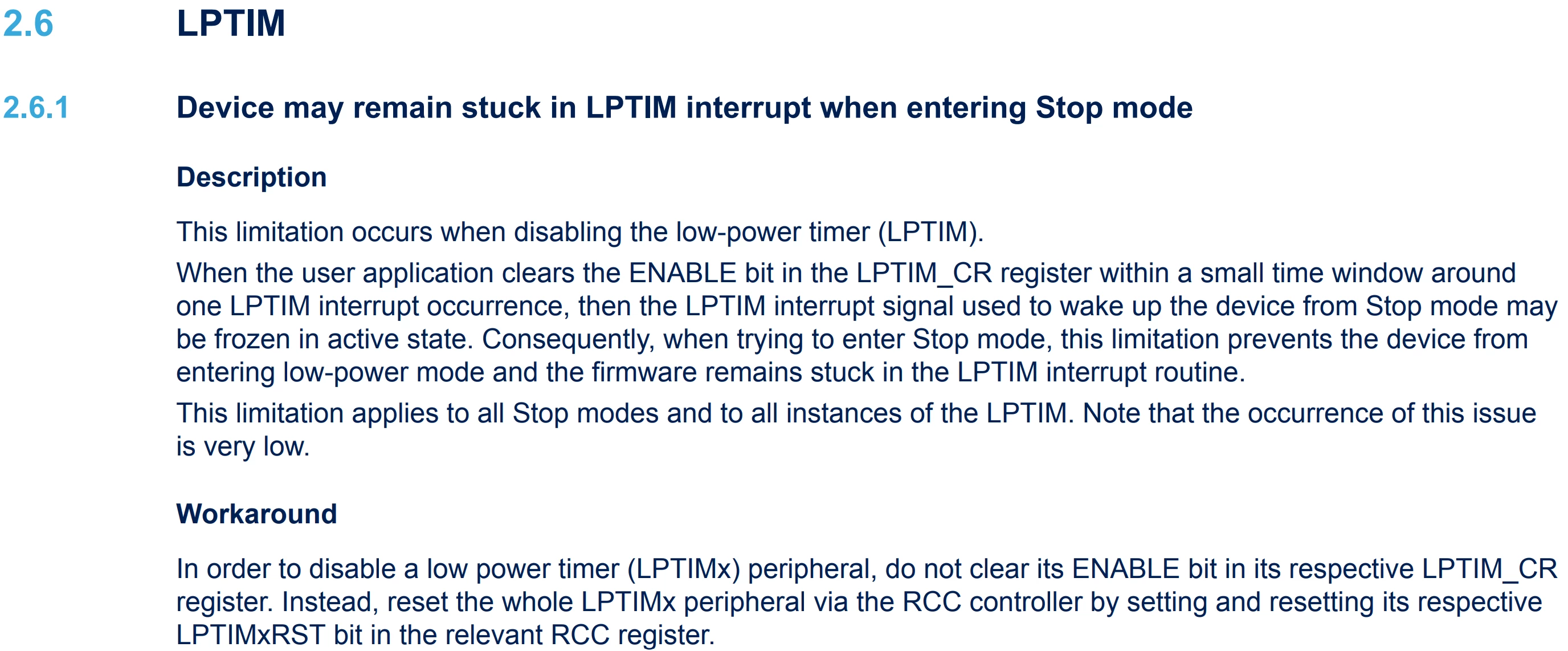

May 15, 2025 3:56 PM UTC
Hello @npatil15;
First check if this limitation is applicable in your case: Device may remain stuck in LPTIM interrupt when entering Stop mode
npatil15Author
Senior
May 19, 2025 9:25 AM UTC
Hello @Sarra.S
Thanks for reply, this limitation does not applicable in my case.
I have gone through this section, and accordingly I'm not disabling LPTIMER in between of any process, actually it is by default enable during init.
As per LPTIMER application if it is enabling all the time then it has to generate interrupt to wake up from stop2 mode. Let me know if I misunderstood the content.
Thanks,
Nitin

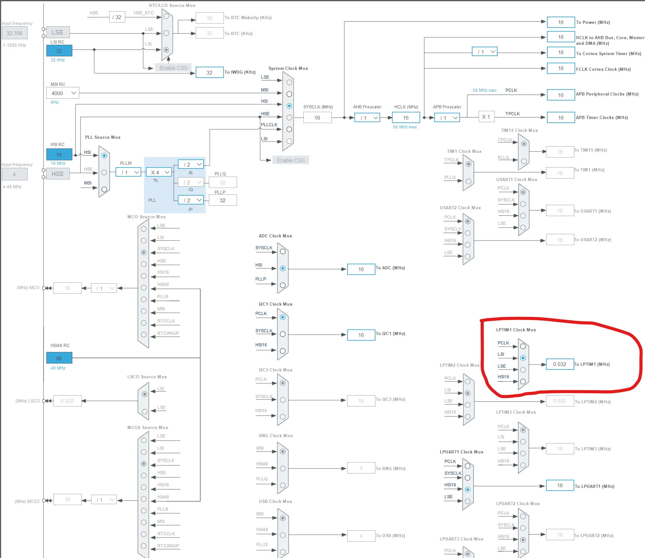

May 19, 2025 3:15 PM UTC
Hello again,
I have jus noticed that the LPTIMER1 is using the APB clock source with a low-power oscillator:
hlptim1.Init.Clock.Source = LPTIM_CLOCKSOURCE_APBCLOCK_LPOSC
The APB clock is not available in STOP2 mode, so consider using an internal low-power oscillator (LSE or LSI)
npatil15Author
Senior
May 20, 2025 4:07 AM UTC
Hello @Sarra.S
Thanks to highlight,
Here, I'm little confuse, as you see in the clock configuration I have set by default LSI clock to LPTIMER1, so I thought it was using LSI clock, but as you said it is not using it.
And here is the clock autogenerated code for reference,
void SystemClock_Config(void)
 HAL_PWREx_ControlVoltageScaling(PWR_REGULATOR_VOLTAGE_SCALE2);
 RCC_OscInitStruct.OscillatorType = RCC_OSCILLATORTYPE_HSI|RCC_OSCILLATORTYPE_LSI;
 RCC_OscInitStruct.LSIState = RCC_LSI_ON;
 RCC_OscInitStruct.PLL.PLLState = RCC_PLL_NONE;
 Error_Handler();
 |RCC_CLOCKTYPE_PCLK1;
 RCC_ClkInitStruct.SYSCLKSource = RCC_SYSCLKSOURCE_HSI;
 RCC_ClkInitStruct.APB1CLKDivider = RCC_HCLK_DIV1;
 if (HAL_RCC_ClockConfig(&RCC_ClkInitStruct, FLASH_LATENCY_1) != HAL_OK)
 Error_Handler();
As per my logic, at every wakeup on interrupt I reconfigure the clock (i.e, re-call SystemClock_Config() to retain its clock again, this is done because I want to run ADC calculation on wakeup so needs HSI clock to use. That is the case in clock configuration I have set LSI default clock to LPTIMER1, so that it will not affect its timing calculation due to wake up.)
Can you check what was wrong in the clock configuration and why it is not setting LSI clock to LPTIMER1?
Thanks,
Nitin
