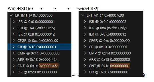

I'm using on a STM32L4R9 a LPTimer1 in interrupt mode. If i use it with the PCLK1, HSI or LSI as clocksource it works as expected. It counts to the ARR value and then the interrupt occours. If i use the LSE as clocksource the LPTimer seems only to count to 1 and the interrupt happens way to often (propably also at 1).
The LSE is also used for the RTC, which works fine.

waclawek.jan
November 15, 2023
Read out and check/post content of LPTIM registers.
November 16, 2023
 Here are the register values left with HSI16 were everything is fine, right side with LSE were it only counts to 1. Both should count to 0.5s. why the ARR value is different. I think it has something to do with the ISR/ICR Flags, I also read about in the errata es0393. But even if i don't use the STM32CubeMX code, I do pretty much the same thing to initialize and start the timer. And the interupt handler is also pretty much the same.
I've also tried different Timer Modes (Counter, Timeout, PWM), the behaviour is always the same.
waclawek.jan
November 17, 2023
Devil is in the details, here, the particular way how you've set up the timer in code. As you've shown us no code, here's some theory.
LPTIM is a dual-clock module - registers are accessed from the system (including processor) through the APB bus, and that domain is clocked by the APB clock; and the real working counters are clocked by the asynchronous clock, in your case LSE.
ARR (and CMP) registers have in fact two copies, one is in the APB domain (let's denote it ARRapb) and other in the asynchronous domain (let's denote it ARRasync). Readback comes from ARRapb, while the actual counter works with ARRasync.
Values written to ARRapb are copied through a hardware mechanism, which works only if the async clock is present This demonstrates itself also in the fact that RM requires LPTIM_CR.ENABLE to be set before ARR is written.
So, what I think happens in your case is, that you perform such sequence of operations, which write into ARR while the asynchronous clock - in your case from LSE - is not present. Maybe it's not stable yet, or maybe there should be delays introduced in some point in your program.
At any case, after the write, you should check if ARRapb has been copied into ARRasync, by checking LPTIM_ISR.ARROK.
November 22, 2023
I think your right, it must be some little detail I'm missing. Though, I was still not able to find the mistake.
I am absolutly sure the LSE is running since it is the pretty first thing I do after the startup code. (it is also checked if it is stable via the RCC_BDCR_LSERDY Flag).
Also the LPTIM_CR.ENABLE to be set before ARR is written and the LPTIM_ISR.ARROK is checked and OK.
I've added the code to start the timer below. It should be pretty much the same as in the cube code but just all the different HAL_LPTIM_Start (PWM_Start, PWM_Start_ISR, OnePulse_Start, ...) function merged into one.
Felix

waclawek.jan
November 22, 2023
I can't judge what this does, as there are many externalities to it.
Reduce this code to bare minimum which performs the action used in your program, while excluding any calls to any external functions and excluding usage of externally defined and filled-in structs. In other words, write the absolute minimum code containing only symbols defined in the CMSIS-mandated device header and explicit writes to registers. Check if it still exhibits the problem, and post.
November 22, 2023
I was trying to change the could so you can read it and thought about were the problem could be. i thought it might have somthing to do with the disable function, since this is very special for the LPTimer. So I stepped through the code and afterwards the timer was running correct. Then I tested with some different breakpoints with the same results depending were I set the breakpoint. In the next step I added a 1ms timeout to different parts of the disable function and checked if the timer works correct or not. In the code below you can see in which range of code the timeout has to be added to get the timer working properly.
In my disable function I do the same things as the CubeMX HAL does and I can't find a similar timeout there, which is why I'm a bit surprised by this, and also not very comfortable that this "fix" will always work.
If you have any thoughts to this I would be happy to hear.
Felix

waclawek.jan
waclawek.janBest answer
November 22, 2023
This doesn't look right:
while ((!(LPTIM1->ISR, (HAL_LPTIM_FLAG_ARROK))) && (count != 0UL));
November 22, 2023
Of course not. I completely overlooked it. Probably because I didn't expect that the compiler wouldn't have an error here.
Thank you
