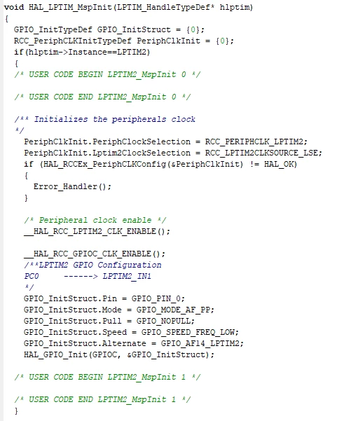

LPTIM2 STM32U585
Dear Sir.
Using stm32u585 , The external clock on OSC32 pins is 32.768 Khz.
I need to config LPTIM2 to run on 32.768 Khz with no success .
How do I configure the SystemClock_Config() to make LPTIM2 to run on 32khz.
Attached a code

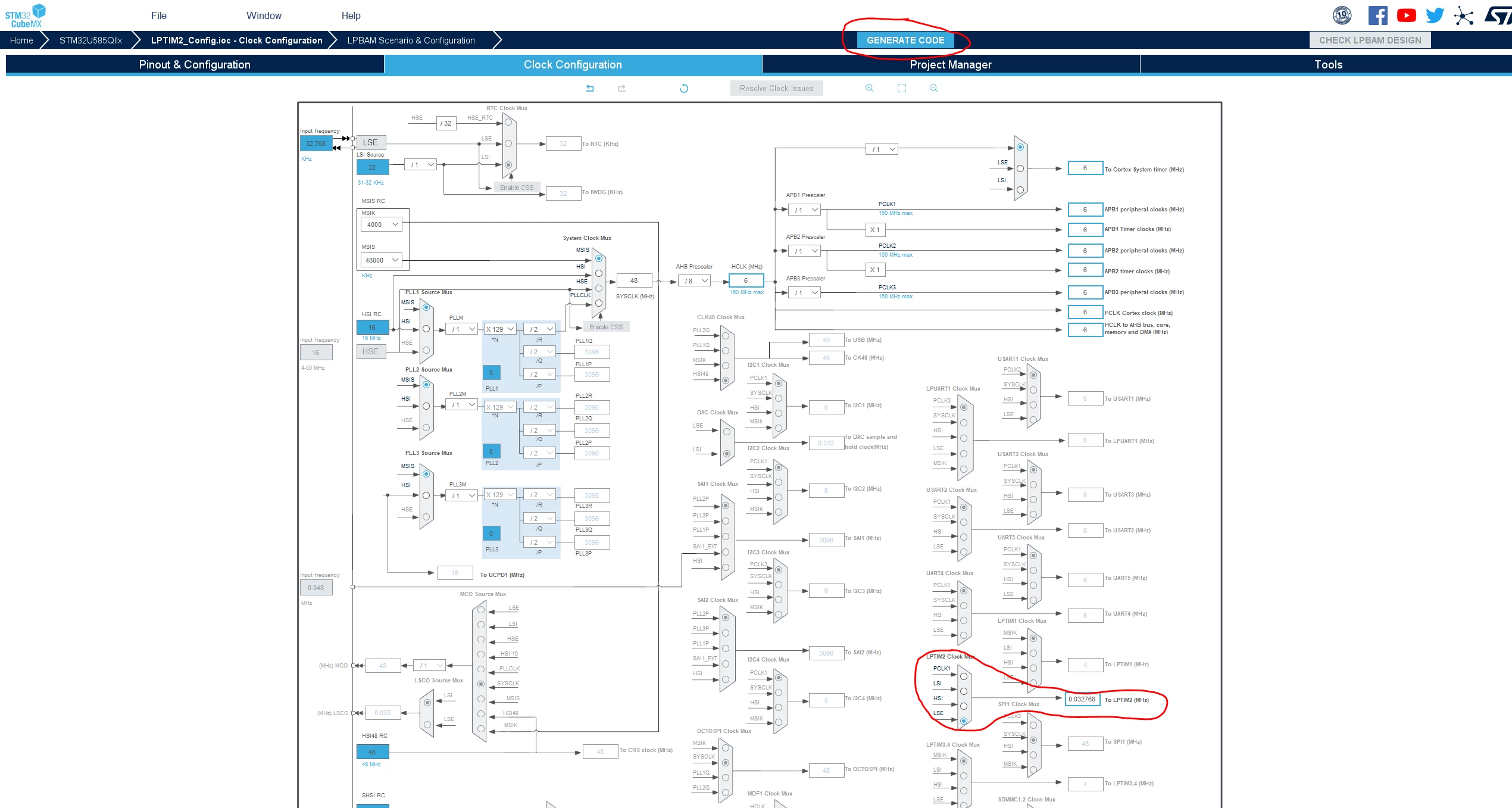

October 18, 2022
Hi @Community member​ ,
In the SystemClock_Config() , you have activated the MSI and LSE clocks and defined the MSI as the system clock source. Now you need to select the LSE as source of your LPTIM2 peripheral.
The easiest way to do that is by using STM32CubeMX to configure the peripheral and then generate the code. Please refer the images below
Best Regards,
A.MVE
