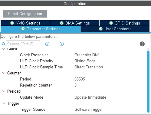

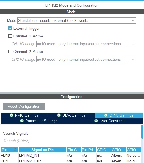

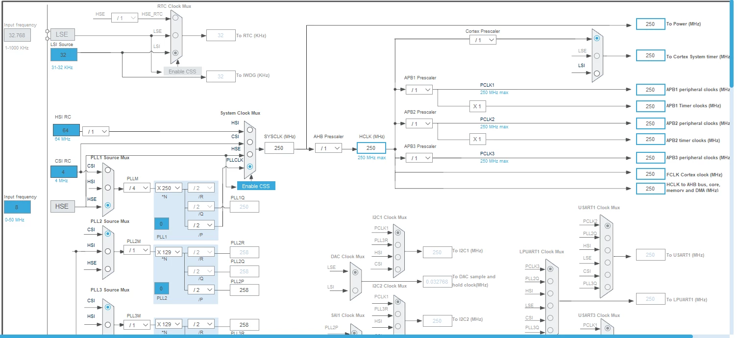

On NUCLEO-H563ZI board I put 3KHz square wave on LPTIM2_ETR (PC4). I want LPTIM2 to continuously count. However the count never increases. LPTIM2 setup...
And
Clock looks like
MX_LPTIM2_Init() looks like
static void MX_LPTIM2_Init(void)
 /* USER CODE BEGIN LPTIM2_Init 0 */
 /* USER CODE END LPTIM2_Init 0 */
 /* USER CODE BEGIN LPTIM2_Init 1 */
 /* USER CODE END LPTIM2_Init 1 */
 hlptim2.Instance = LPTIM2;
 hlptim2.Init.Clock.Source = LPTIM_CLOCKSOURCE_ULPTIM;
 hlptim2.Init.Clock.Prescaler = LPTIM_PRESCALER_DIV1;
 hlptim2.Init.UltraLowPowerClock.Polarity = LPTIM_CLOCKPOLARITY_RISING;
 hlptim2.Init.UltraLowPowerClock.SampleTime = LPTIM_CLOCKSAMPLETIME_DIRECTTRANSITION;
 hlptim2.Init.Trigger.Source = LPTIM_TRIGSOURCE_SOFTWARE;
 hlptim2.Init.Period = 65535;
 hlptim2.Init.UpdateMode = LPTIM_UPDATE_IMMEDIATE;
 hlptim2.Init.CounterSource = LPTIM_COUNTERSOURCE_EXTERNAL;
 hlptim2.Init.Input1Source = LPTIM_INPUT1SOURCE_GPIO;
 hlptim2.Init.Input2Source = LPTIM_INPUT2SOURCE_GPIO;
 hlptim2.Init.RepetitionCounter = 0;
 if (HAL_LPTIM_Init(&hlptim2) != HAL_OK)
 Error_Handler();
 /* USER CODE BEGIN LPTIM2_Init 2 */
 /* USER CODE END LPTIM2_Init 2 */
Startup looks like
MX_LPTIM2_Init();
/* USER CODE BEGIN 2 */
HAL_LPTIM_Counter_Start(&hlptim2);
 Following HAL_LPTIM_Counter_Start() CR = 0x5 and and CFGR = 0x800001. But CNT is zero. Same result if I use alternate ETR PE0.
What is missing?

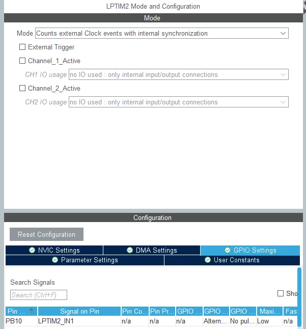

Thank you! Using LPTIM_INPUT1SOURCE_GPIO works. LPTIM2 configured with STM32CubeIDE as follows...

Hello @mccabehm,
The input source is set to LPTIM_INPUT1SOURCE_GPIO, which means that the LPTIM2 is expecting the input signal to come from a GPIO pin, however, your input signal is coming from an external trigger pin (PE0 or PC4).
Try changing the input source to LPTIM_INPUT1SOURCE_EXTERNAL
Hope that helps!

No, not a solution yet! Any way undo the accept?
The initialization already sets clock source to LPTIM_COUNTERSOURCE_EXTERNAL. Not clear to me why I need input sources at all. At one time LPTIM1, LPTIM2, and LPTIM6 worked fine. Then something unknown changed and none of the LPTIMs count.
