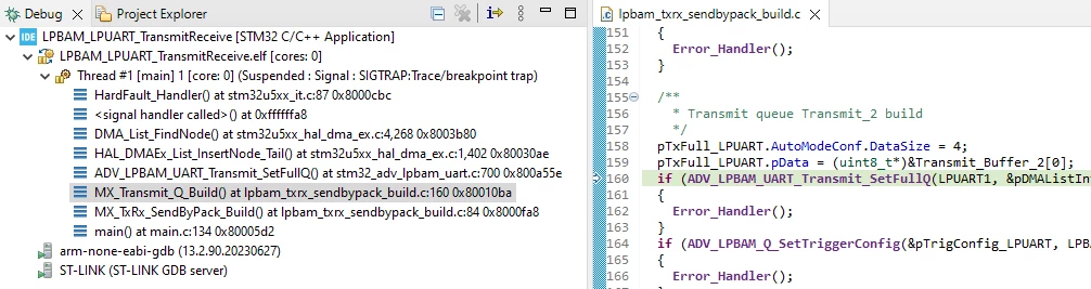

I'm trying the LPBAM_LPUART_TransmitReceive with a NUCLEO-U575ZI-Q but I can't make it works.
I enabled the debug by removing the init of PA13 and PA14. The MCU got stuck into an hardfault when calling ADV_LPBAM_UART_Transmit_SetFullQ() for the second time:
Any idea what is wrong, thanks in advance ?

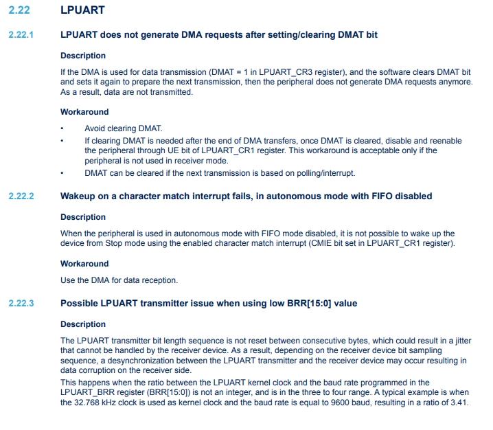

Did you properly initialize and configure the LPUART and DMA before calling   ADV_LPBAM_UART_Transmit_SetFullQ() function?
Check the DMA configuration and make sure that the DMA channels are properly set up for the LPUART transmit and receive operations.
Did you look at the STM32U575 errata sheet and check if you have the known limitation related to the LPUART that could be causing this issue.

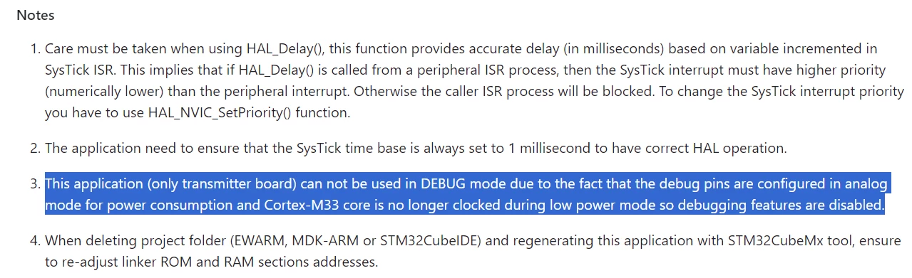

I've tested the example on NUCLEO-U575ZI-Q (MB1549) and it works as expected.
=> This application (only transmitter board) can not be used in DEBUG mode due to the fact that the debug pins are configured in analog mode for power consumption and Cortex-M33 core is no longer clocked during low power mode so debugging features are disabled.
Please check this point as described in the readme file.

I know that but with the unmodified code, the blue led never turn on.
And with debugger, the code crash before going into low power.
Would it be possible to have a binary file so i can know if i have a problem with my hardware or with my compilation ?
