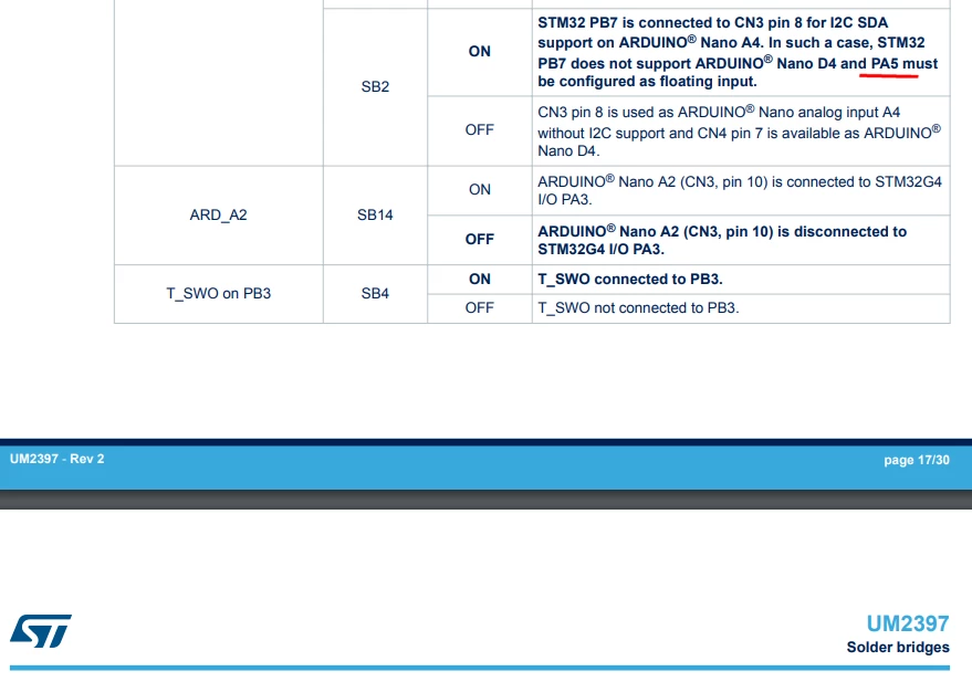

Hello STM community,
I have a problem with my Nucleo-G431KB. I am trying to communicate to a sensor device over SPI. The problem I have is that when I use PA5 as SPI1_SCK, the logic high is only 1.4 V instead of the 3.3 V on other pins. When I configure PA5 as normal GPIO output I also get a 1.4 V output. When I use another pin as SPI1_SCK it works as expected.
I have this problem when the Nucleo is connected to the sensor, but also when there is no load except for the oscilloscope.
At first I thought that it might be a production error, but I have the problem on both of my boards.
Is it normal that this pin has a lower voltage? If so, can I change it somehow?

from circuit :
seems PA5 connected to PB7 (dont ask me why ! ) ; so open SB7 to get PA5 working as expected.

Have you checked the board's User Manual and/or Schematics to see if there's anything else on that pin?

@AScha.3 wrote:
don't ask me why !
Something about "I2C SDA support on ARDUINO Nano A4"
October 30, 2024
Thanks!
I put PB7 and PA15 (connected to PA6 for MISO) to the reset state, and now the SPI works.
If I want to use PB7 and PA15 for something else I should open SB2 and SB3, if I see things correctly.
