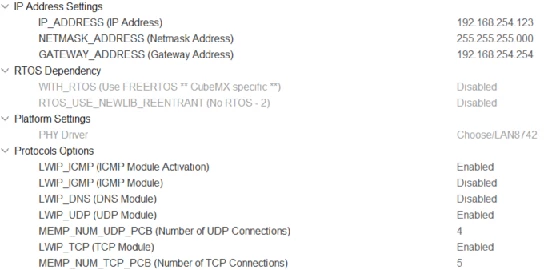

as best as I could given the RMII vs his MII as well as sizes because the 723 is smaller and the code compiled and I do not get fault errors when running.  However I do get Destination Host Unreachable constantly.

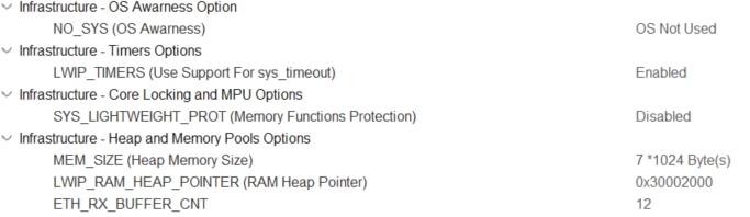

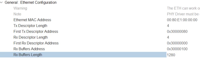

My CubeMX ethernet settings are:
LWIP settings:
The sizes keep everything within SRAM1 per the datasheet (0x30000000 - 0x30003FFF)....

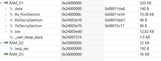

When I run I don't crash or hang up but I do notice that in the Build Analyzer section I do NOT get the .RxAarraySection to show up.  And here is the confusing part...Notice RAM_D1 seems to be showing the RxDecriptSection, etc at 0x24000000 space vs RAM_D2....From your experience can you shed any light on this?
Thanks
Steve
LCE
Principal III
Oct 4, 2024 1:02 PM UTC
Alone seeing this "RxDecriptSection" from Cube gives me the creeps... :D But I'm a little oversensitive with things like that.
Anyway,
0) RMII should be no problem, setup is handled well be Cube.
1) It's important that the descriptors are in SRAM1, the TX / RX buffers can also be in AXI SRAM - where you actually placed the lwip pool (used for lwip packet buffers "pbuf"), which is okay.
Check RM0468, 2 Memory and bus architecture, it starts with a table which bus master (incl. ETH DMA) can access which RAM or peripheral.
2) rxBuff: the declaration looks good, so is that actually used somewhere? Should be... but I don't use the ETH HAL driver.
I would debug with a breakpoint somewhere in "ethernetif.c" where ethernet data is received and given to lwip.
As I said, it will be lots of work, with lots of frustration - but the H7 can do it!
