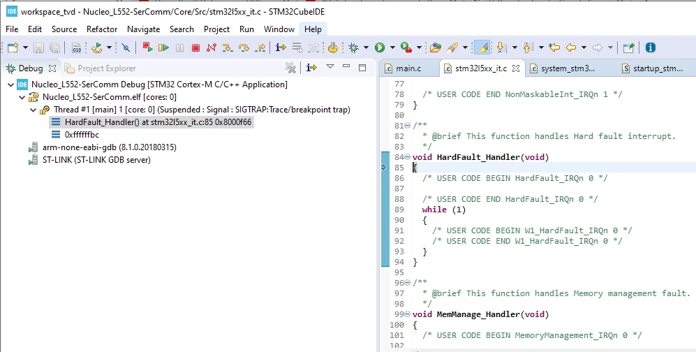

Looking for solution to hard fault when using UART to transmit. Particularly, when it calls HAL_GetTick() in Uart function
Hi all,
I am using Nucleo-L552 Evaluation board running , CMSIS_RTOSV2 (FreeRTOS), firmware STM32Cube FW_L5 V1.3.0. Debugging via built-in ST-Link. I have a Hard fault on HAL_GetTick() when running UART transmit on one of the threads. It debugs fine with the threads toggle the LEDs, but running into hard fault when add code trying to send via uart. I wonder anyone ran into the same problem?

I then run debug but it keeps failing on
I don't see where I can change or check for the IT priority of the UART. I would appreciate if you show me.

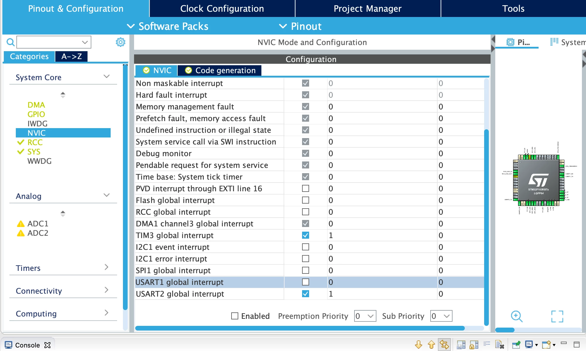

selcukozb
September 6, 2020
0693W000003QrMdQAK.pngHi TDinh,
I couldn't check the data you've given completely. But shortly answer where to find and change IRQ priorities.
Within your code you can learn the priority level of a specific IRQ, you can use :
HAL_NVIC_GetPriority(IRQn, PriorityGroup, pPreemptPriority, pSubPriority);
And setting its priority amy required value :
HAL_NVIC_SetPriority(IRQn, PriorityGroup, pPreemptPriority, pSubPriority);
You can also set priority level during project configuration within cubeMX, under System/NVIC settings window. See thee attached screen shot. As you can see I set Time3 and UART2 interrupts a lower level compared to sysTick.
Hope this will help.
Kind Regards,
selcukozb
September 6, 2020
Hi TDinh, I looked into your code and noticed that you don't use UART with Interrupts. So, my comments in the previous posts are invalid. There should be something else, which I can not suggest anything without debugging with SWV. I advise you to do so.
Sorry, I could not help.

TDinh.1
TDinh.1AuthorBest answer
September 6, 2020
Thanks selcukozb, I suspect there is something to do with the timebase source. I reconfigured the timebase to use SysTick instead of TM6 as suggested by various youtub tutorials and it works.
Although, when using STM32 with freeRTOS the CubeMX gives you a warning:
when freeRTOS is used it is strongly recommended to use a HAL time base source other than the systick"
I think I will use SysTick as timebase for now.
Thanks again selcukozb.
