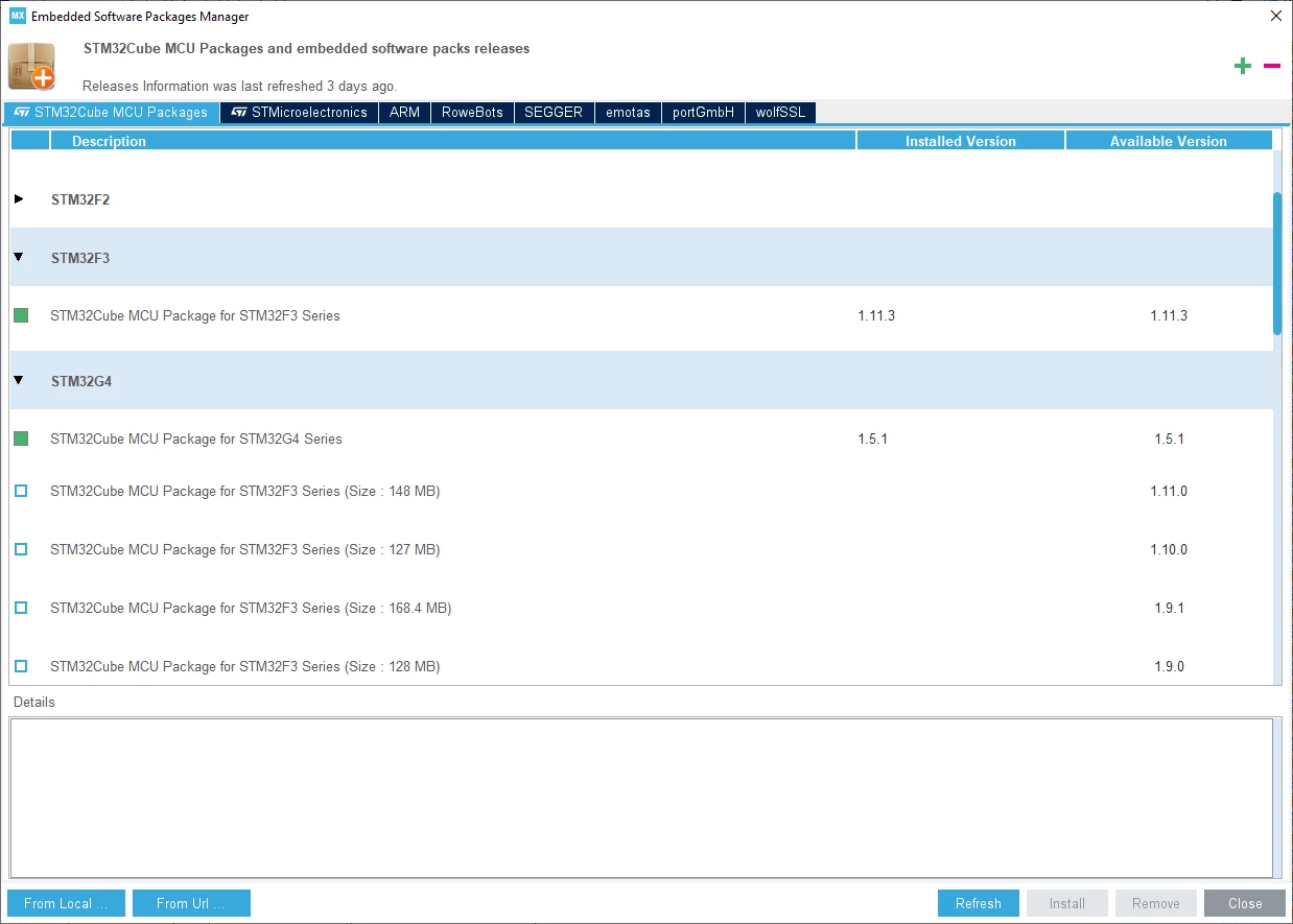

Thanks! do you know how do I download the files from GitHub?
I have never used it before.
victagayun
Senior III
July 19, 2022
You use CubeMX to download the firmware.
Here is F3 and G4 already downloaded.
Then navigate to the Repository folder.
for F3 >>> Repository\STM32Cube_FW_F3_V1.11.3\Projects\STM32F3348-Discovery\Examples\HRTIM\HRTIM_TM_PFC
for G4 >>> Repository\STM32Cube_FW_G4_V1.5.1\Projects\B-G474E-DPOW1\Examples_MIX\HRTIM\HRTIM_PFC_TransitionMode
