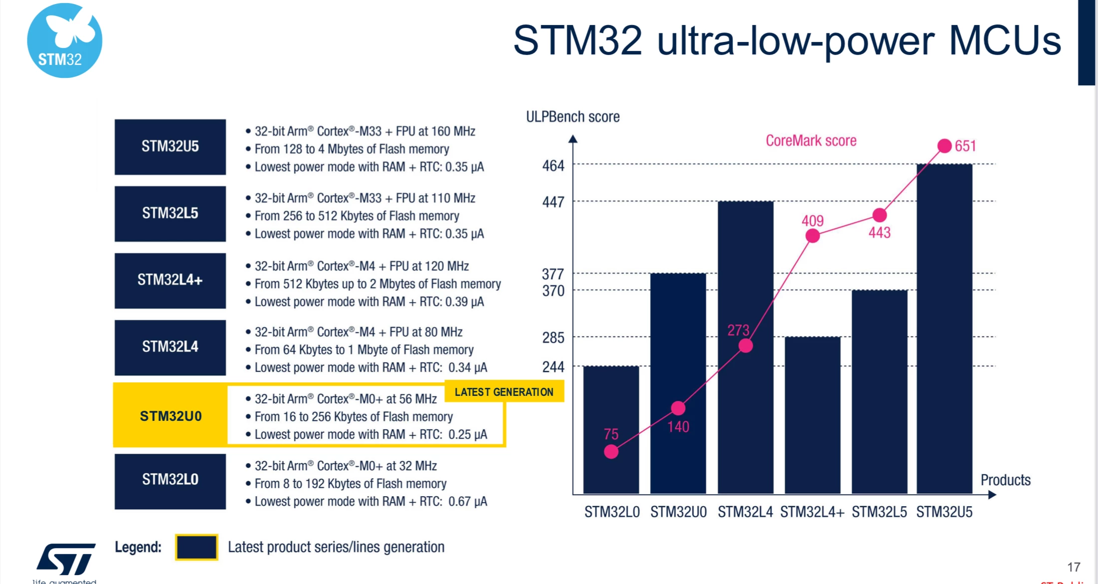

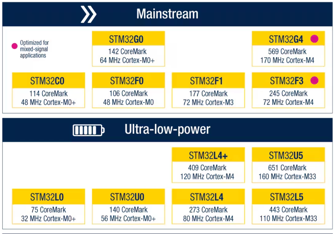

STOne-32
June 29, 2024
A1) I believe in this use case . STM32C0 is enough - Cost is key on C0 family
A2) ULP family is used in general when more than 95% of time the MCU is in standby or STOP mode , a bit expensive to have that premium less nA / uA
U0 is only natural upgrade of L0 series with refreshed features of performance and security.
Have a great day
ST1
