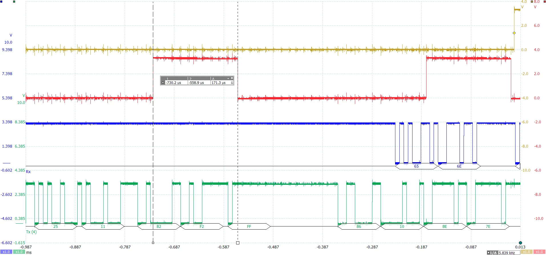

While implementing a full duplex uart (115kBaud) communication on an STM32F303, I'm struggling quite a bit.
My current problem is that the DMA1_Channel2_IRQn takes 170μs. I'm using DMA to TX data from the STM. Receiving data is handled via interrupt. In the 170μs, two bytes can be received. Since the DMA1_Channel2_IRQn takes so long, the UART Interrupt for receiving is called after these two bytes which results in an overrun error :(
I have attached an oszillogram:
Ignore yellow(top),
Red is the duration of UART_WaitOnFlagUntilTimeout(huart, UART_FLAG_TC, RESET, HAL_UART_TXDMA_TIMEOUTVALUE), which is called from DMA1_Channel2_IRQHandler
Blue is Rx data
Green is Tx data
What I don't understand: Why is DMA TC arriving so early (while TXing byte 0x82)? And why does it take so long until the UART TC flag is set?
As you can see on the right side, a DMA_TC is happening while data is received. The RX interrupt can be called only after a byte is lost. How can I handle this? Would nested interrupts solve this problem?

    Imagine, your system wanna send only two bytes via UART using DMA.
    The UART has actually a small FIFO: the ''visible'' data register DR and a ''shadow'' shift register, that makes the bit sequence at the TX pin.
    The DMA writes the first byte to DR. The byte goes to the yet ''empty'' shadow register immediately, and the serialization starts. DR gets free at this moment and is ready for the next byte. DMA sees this and writes the second byte to DR. So, the DMA has made its job and sets TC (transfer complete!), while the UART is still handling two bytes written: the first is still on the way via TX (think on baud rates that are very very slow comparative to the CPU/DMA speed), while the second byte is waiting in DR. The UART TC bit is set when both shadow and DR registers get empty, and it takes time.
    The solution is (I do this way): in the DMA TC interrupt disable it but enable the UART TC interrupt. Process the ''packet complete'' in the UART TC interrupt and disable it, prepare the new packet by reinitializing the DMA and enable its TC interrupt again, and so on. This would never block the RX interrupt of the UART.
    The next hint: make the RX interrupt priority higher than TC interrupts of DMA and UART.

    Don't use DMA TC interrupt to manage USART TC. Have your USART IRQ Handler manage RXNE and TC
    USART TXE asserts, byte N-1 hits the wire
    DMA writes last byte to USART DR, byte N
    DMA TC asserts
    .. one byte time
    USART TXE asserts, byte N hits the wire
    No DMA service, TXE remains asserted
    .. one byte time
    USART TC asserts

    many thanks for your explanations. Now I have been able to get the communication running with very short interrupt times :)
