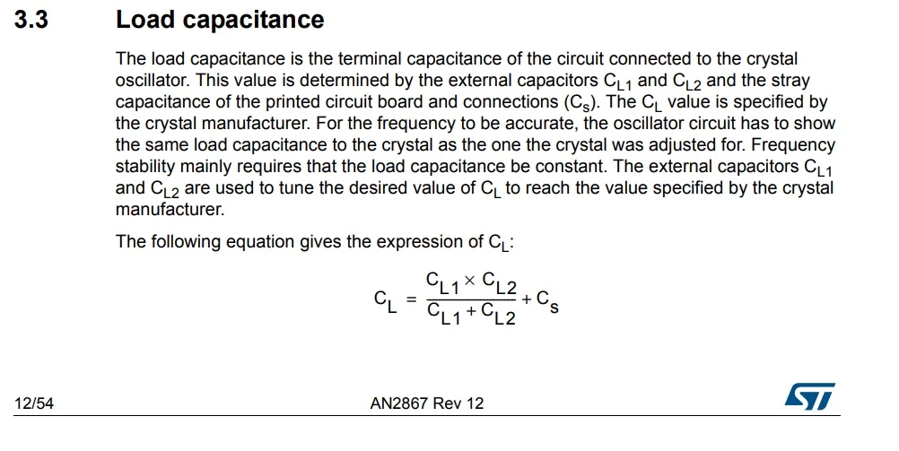

I am working in small startup in Bangalore. I had designed the board using the STM32F103R8T6 controller now i am facing oscillator issue, oscillator is not working as i expected.

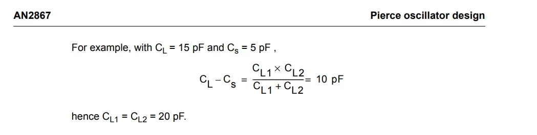

thereafter i googled it for oscillator design guide and i found AN2867. i was reading AN2867 everything explained neatly. in Load capacitance section (page number 12/54) they explained the CL value by taking one example.
CL=15pF, Cs=5pF,
then CL=10pF,
then CL1=CL2=20pF.
at last how CL1 and CL2 become 20pF?
1) if CL value is doubled then why it is doubled?
2)if CL value is multiplied by 2 then why it is multiplied by 2?
3) Load capacitance value should be mentioned by crystal manufacturer, then how CL should become change than the original value?
4) Does designer should use manufacture specified value or should we go through this AN2867 ?
kindly answer my question.

CL must be taken from crystal's datasheet. Do you understand the word "example"?
When C1=C2, the equation simplifies... It's basic math. The same, but simplified: https://blog.adafruit.com/2012/01/24/choosing-the-right-crystal-and-caps-for-your-design/

I had gone through the AN2867, i calulated the CL value.
As per crystal datasheet CL value is 18pF.
After reading the AN2867, CL= 18pF, Cs= 5pF,
Then CL - CS =18pF - 5pF = 13pF.
Now Cl1 = CL2 = 26pF.
Here my question is now which capacitor value should i use?, one which datasheet recommends (18pF) or one which I got values from the as per AN2867 application note (26pF).
Kindly find the attached crystals datasheet link and CL1 and CL2 capacitor datasheet link.

You have to know; in crystal datasheet you find load capacitance (CL) that gives the nominal oscillation frequency. In order to obtain the adequate frequency, the oscillator circuit has to show the same CL to the crystal. That is why, the CL value is determining by the external capacitors (CL1, CL2) and the stray capacitance of the printed circuit board and connections (Cs).
This lead you to the equation in AN2867:  CL(crystal)  = ((CL1CL2) / (CL1+CL2)) +Cs
 I confirm your calculation of CL1 = CL2 = 26pF.
