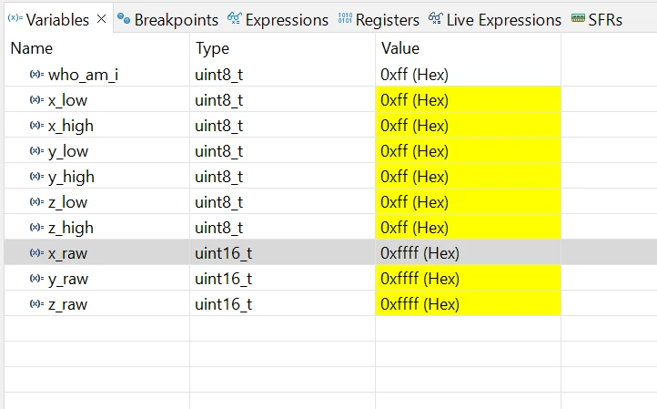

I’m accessing the ‘who_am_i’ register along with the high and low registers for the x, y, and z axes. Upon debugging, I’ve found that the high and low values for the x, y, and z axes are consistently 0xff, resulting in raw x, y, and z values of 0xffff.
Notably, these values remain unchanged even when the board is in motion.

After debugging, values are obtaining as follows:

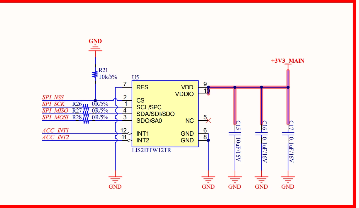

Please post your schematic showing the connections between the STM32 and the LIS2DTW12
July 29, 2024

Here is the schematic:
The who_am_i register is not return the correct value(0x44). Instead it return 0xff.

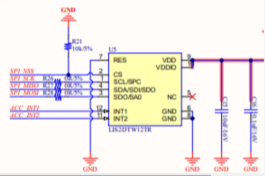

That suggests that your SPI is not working at all. So, again:
  • Are there any other devices on the same SPI bus? If so, are they working OK?
  • Have you used a logic analyser or oscilloscope to verify what's happening on the wires?
The schematic image is too low-resolution to read clearly.
Andrew Neil
July 29, 2024
Your schematic is still pretty low-res:
July 30, 2024
Hi Andrew,
Sorry for the low picture resolution. Here is the new one, please check it. Screenshot 2024-07-30 093828.png
Andrew Neil
July 30, 2024
@DivyaJayan wrote:
Hi Andrew,
Thanks - that's much better!

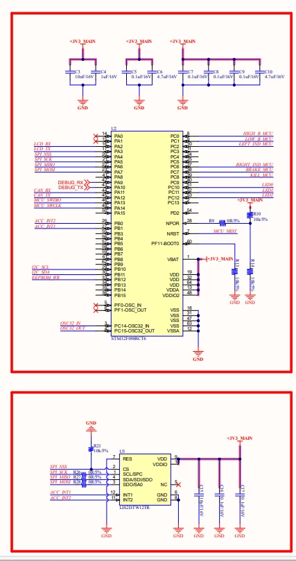

Please also post one for the STM32 part.
Why do you have a pull-down on CS ?
How is your PA4 pin configured ?
