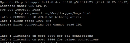

(linux) openOCD, trying to flash a stm32F072 with a rasberryPi

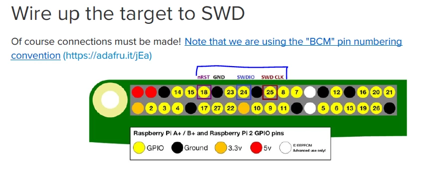

Im following this adafruit tutorial (gpio bitbanging swd).
As they are flashing an AVR chip and i want to flash an stm32f072 chip im using a different .cfg file:
source [find interface/raspberrypi2-native.cfg]
transport select swd
set WORKAREASIZE 0x2000
source [find target/stm32f0x.cfg]
reset_config srst_only srst_nogate
#transport select swd
adapter srst delay 100
adapter srst pulse_width 100
init
targets
reset halt
program myfirmware.bin verify reset
shutdown
im using a RaspberryPi 3 model B v1.2.
my stm32 chip is externaly powered.
Wiring is made as follows:

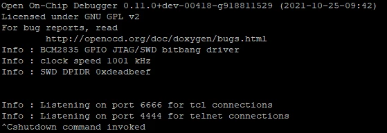

Once i do "sudo openocd" i get randomly 3 different errors in reading IDR:
  • IDR 0x0000000
  • IDR 0xdeadbeef,
  • cannot read IDR

i followed this other tutorial and now it detects DPIR
https://zansprojects.blogspot.com/2019/01/stm32-remote-debugging-with-raspberry.html
I used now my rasberry zero , rewired everything as this new tutorial says , and im trying to flash an stm32f105
im still suspicious about not being able to halt the chip "target not halted"
im not able to halt the chip nor flash any programm.
