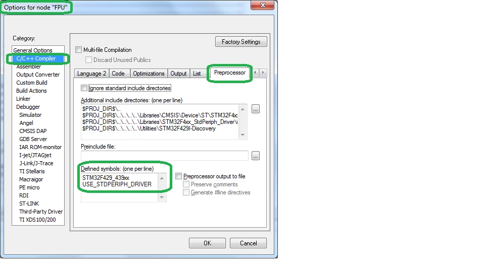

    frankmeyer9
    November 21, 2013
    Posted on November 21, 2013 at 08:41
    Add the preprocessor macro ''USE_STDPERIPH_DRIVER'' to your project settings, this should solve the problem. Not sure how to do this in the IAR WB. In a Makefile-based project, one would append ''-DUSE_STDPERIPH_DRIVER'' to the CFLAGS.
    If you want to know why, look how this macro is used in stm32f4xx.h.

    Tesla DeLorean
    Guru
    November 22, 2013
    Posted on November 22, 2013 at 03:29
    Here the defines used for the STM32F429I-DISCO, I prepared the art so posting it all the same.
    0690X000006054XQAQ.pngI'm not sure it matters if you defined the function or not, it's in one of the project files, shares the same name space, and clashes with yours. So you'll either have to use a different name if it's a different function, or pick which of the instances or files you want to use.

    AvaTar
    Senior III
    August 4, 2016
    Posted on August 04, 2016 at 11:29
    Have you added the define ''USE_STD_PERIPH_DRIVER'' to your project ?
