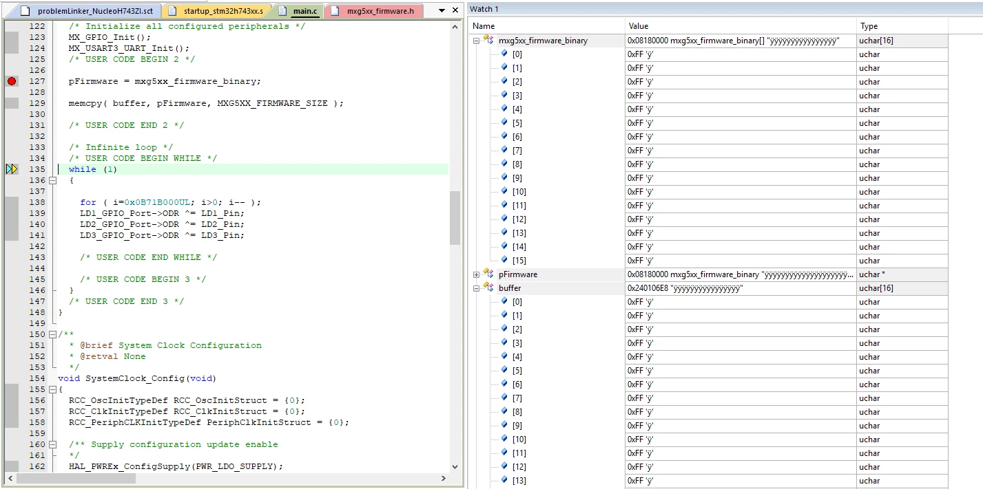

Hello everybody
Controller: STM32H743ZI
I have a const uint8_t array which I want to place in the flash at a specific location. The location is Address: 0x08180000. For that reason I created a *.sct file. The used tag is "MXG5XX".
LOAD_FLASH_BANK 0x08000000 0x00200000
 EXEC_FLASH_BANK_1 0x08000000 0x00100000
 *.o (RESET, +First)
 *(InRoot$$Sections)
 .ANY (+RO)
 .ANY (+XO)
 EXEC_FLASH_BANK_2 0x08180000 0x00080000
 *(.MXG5XX)
 EXEC_DTCM 0x20000000 0x00020000
 .ANY (+RW)
 .ANY (+ZI)
 EXEC_AXI 0x24010000 0x00070000
 .ANY (+RW)
 .ANY (+ZI)
 EXEC_ITCM 0x00000000 0x10000
 .ANY (itcm)
The const array is called mxg5xx_firmware_binary and is defined as follows:
__attribute__((section (".MXG5XX")))
const uint8_t mxg5xx_firmware_binary [] = {
	0xB0, 0x14, 0x00, 0x20, 0xDD, 0x11, 0x00, 0x00, 0xE5, 0x11, 0x00, 0x00, 0xE7, 0x11, 0x00, 0x00
After the build process the *.map shows the following for the array:
Image Symbol Table
mxg5xx_firmware_binary 0x08180000 Data 16 main.o(.MXG5XX)
So far everything seems to be correct.
If I start debugging now the address for the const array is correct (0x08180000) but the memory at this address shows only 0xFF and not the values defined for the array.
I have a minimum project for NUCLEO-H743ZI.
Any Idea? Thank you.
Regards
Jakob
Tesla DeLorean
Tesla DeLoreanBest answer
Guru
Jul 15, 2020 11:43 AM UTC
The base addresses need to be consistent, you can't have the data floating in the middle of the load region, the scatter loader wants to unpack it.​
5 replies
Tesla DeLorean
Guru
Jul 15, 2020 6:29 AM UTC
Split into two load regions, with the second describing the last 512KB, and put the second execution region inside that.

jakob.brunhart
Jul 15, 2020 6:37 AM UTC
Hi Clive
Thank you for your response.
Do you mean like this:
LOAD_FLASH_BANK_1 0x08000000 0x00100000
 EXEC_FLASH_BANK 0x08000000 0x00100000
 *.o (RESET, +First)
 *(InRoot$$Sections)
 .ANY (+RO)
 .ANY (+XO)
 .ANY (+RW)
 .ANY (+ZI)
 .ANY (+RW)
 .ANY (+ZI)
 .ANY (itcm)
LOAD_FLASH_BANK_2 0x08100000 0x00100000
 ;EXEC_FLASH_BANK_2_1 0x08100000 0x00080000
 EXEC_FLASH_BANK_2_2 0x08180000 0x00080000
 *(.MXG5XX)
It behaves the same.
Regards
Jakob
Tesla DeLorean
Guru
jakob.brunhart
Jul 15, 2020 11:54 AM UTC
... Thank you. This version works.
 *.o (RESET, +First)
 *(InRoot$$Sections)
 .ANY (+RO)
 .ANY (+XO)
 .ANY (+RW)
 .ANY (+ZI)
 .ANY (+RW)
 .ANY (+ZI)
 .ANY (itcm)
LOAD_FLASH_BANK_2 0x08180000 0x00080000
 EXEC_FLASH_BANK_2 0x08180000 0x00008000
 *(.MXG5XX)
