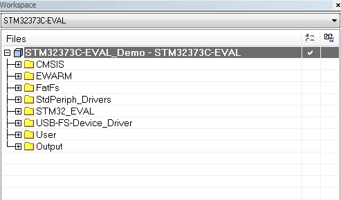

I've included STM32_USB-FS-Device_Driver in my project. When I compile (in IAR) I get a bunch of errors

    Erenburg.Evgeny
    February 21, 2018
    Posted on February 21, 2018 at 13:13
    There is no
    Receive_Buffer inclusion
    - not in
    usb_core
    .c/h not in
    usb_init
    .c/h. Nothing to be 'duplicate'.
    Besides it's  STM  USB Library - I didn't write a line of code in it.
    I've just opened a demo project (from STM32373C-EVAL_FW_V1.0.0) and it compiles OK - with this library (STM32_USB-FS-Device_Driver).
    But in my project the library compiled with errors.
