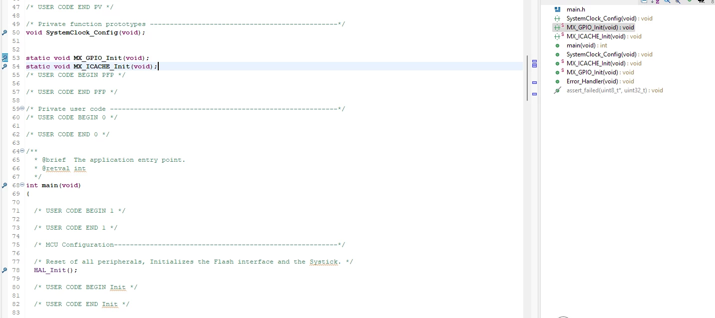

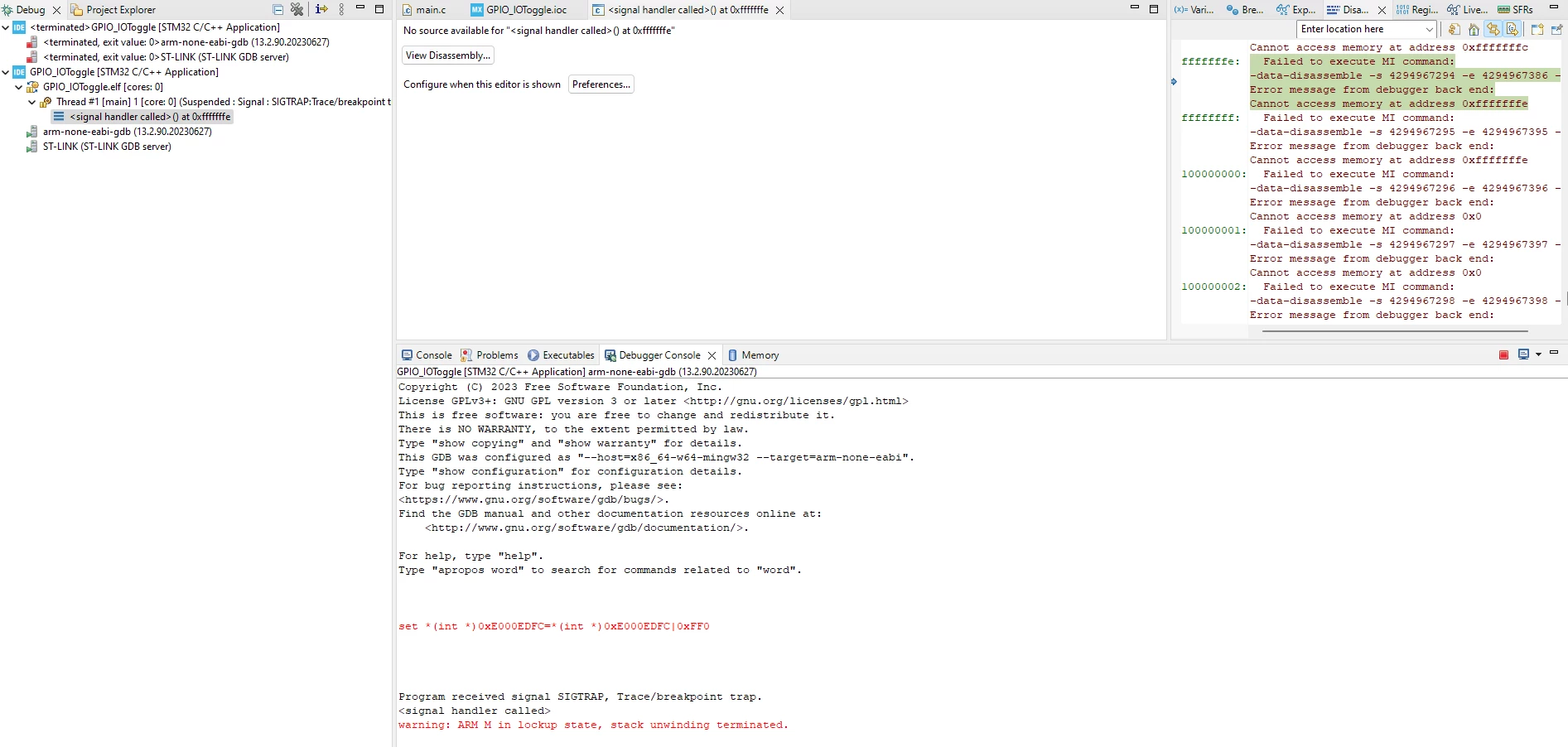

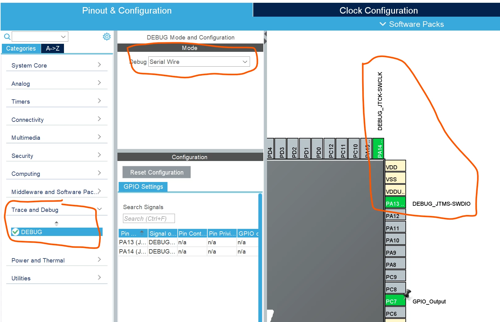

I am trying to toggle one of the LED lights of STM32 NUCLEO-L552ZE-Q board. I am working with the latest version of STM32CubeIDE 1.16.1. The steps I followed are given in the picture. However, I find this error when I debugg:
set *(int *)0xE000EDFC=*(int *)0xE000EDFC|0xFF0
Program received signal SIGINT, Interrupt.
0x080006bc in HAL_IncTick () at ../Drivers/STM32L5xx_HAL_Driver/Src/stm32l5xx_hal.c:303
303 }
Also, the pics show more. I tried many things to fix this issue but couldn't.
Has someone face the same issue and how did you solve it? Any help is highly appreciated.

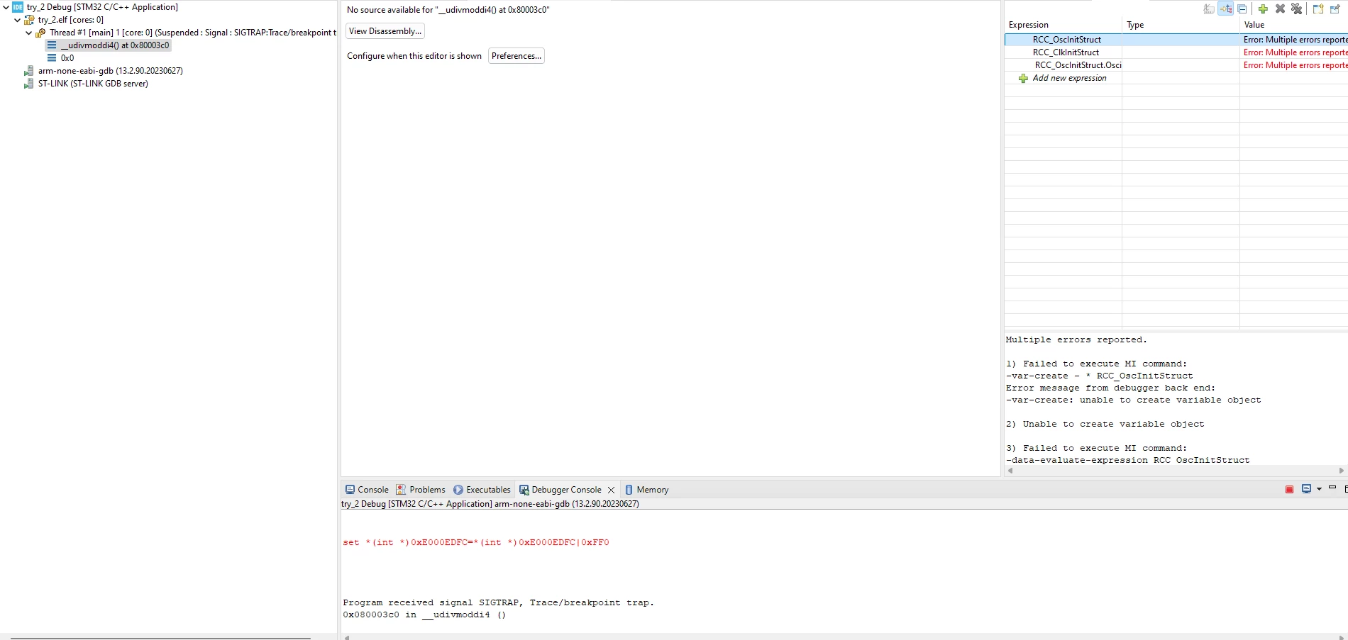

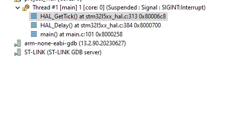

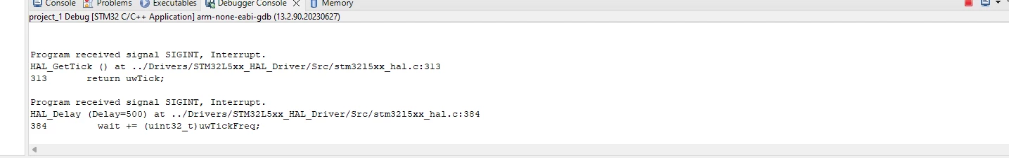

emb_rfAuthor
September 29, 2024

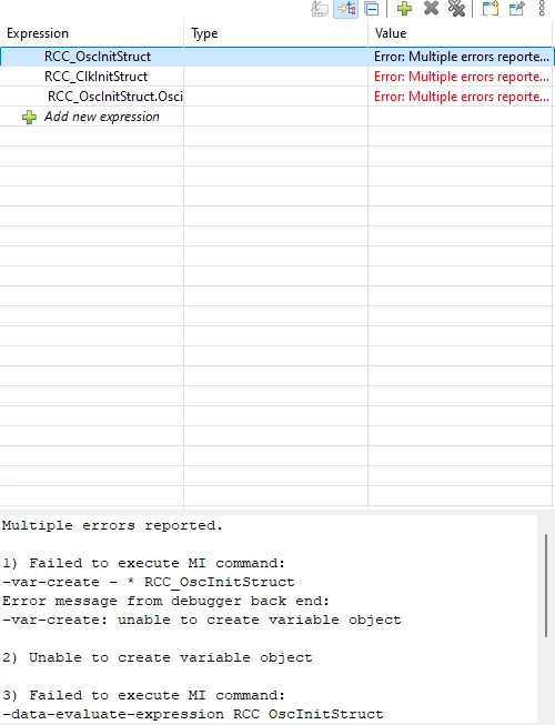

The images of the errors:
Am I doing something wrong in the configuration or ???

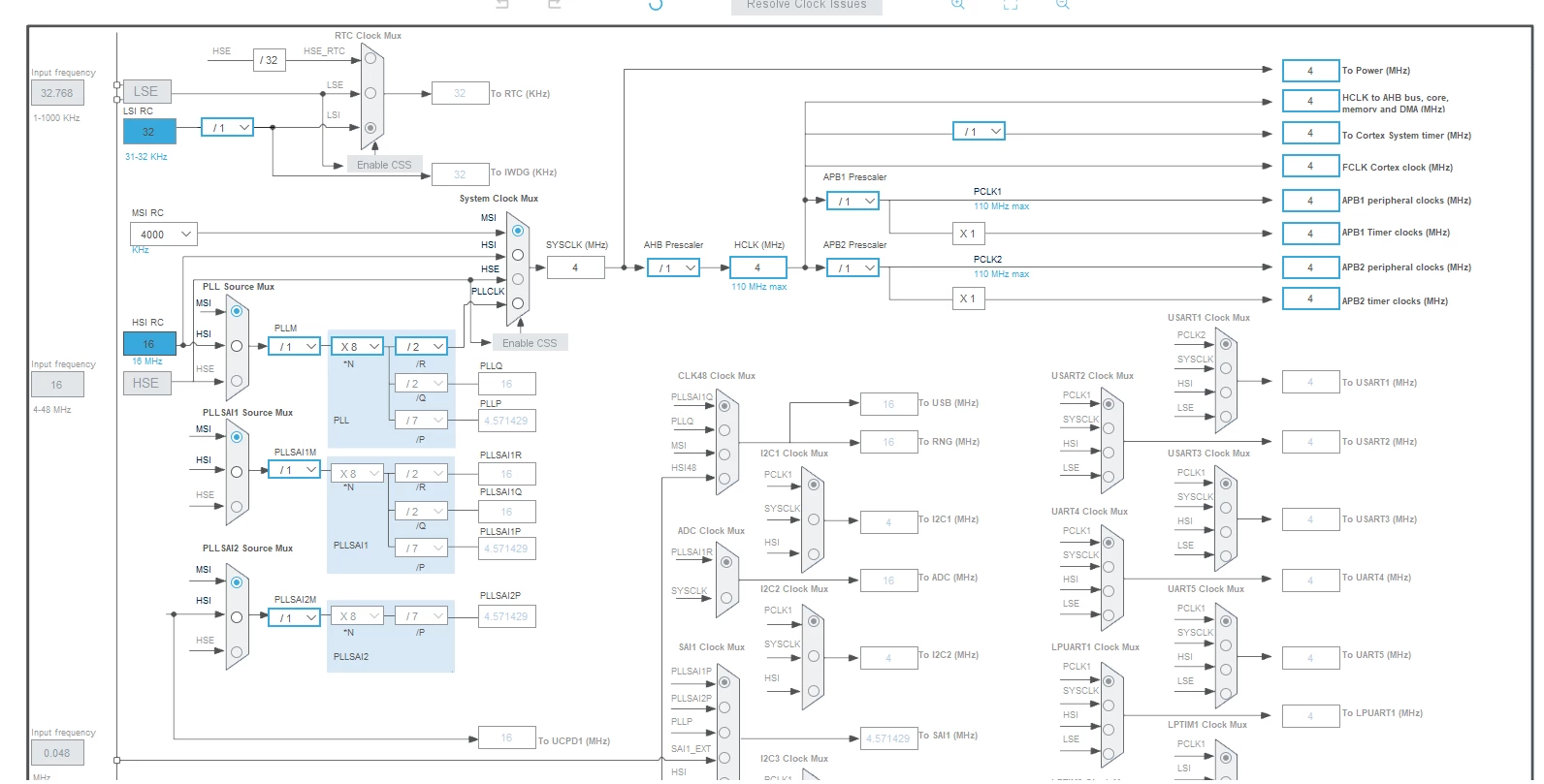

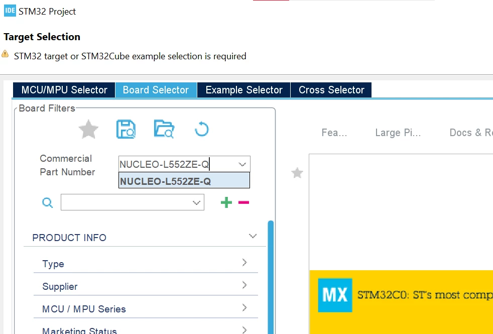

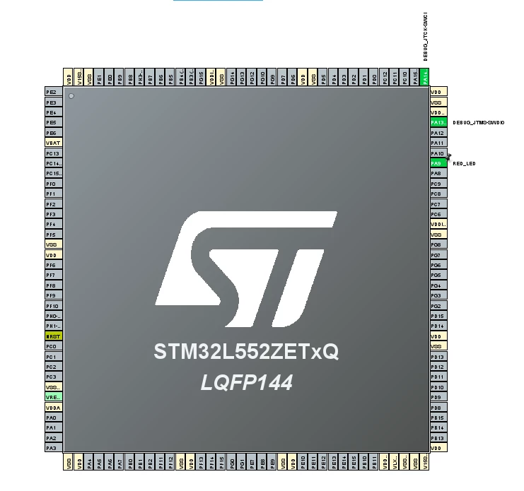

Why is your clock at 4MHz? Anyways, why don't you use the Board Selector which will make sure everything is optimally setup including the clock.
If a reply has proven helpful, click on Accept as Solution so that it'll show at top of the post.CAN Jammer an open source CAN bus hacking toolCANableV3 Open Source
emb_rfAuthor
September 29, 2024
It didn't work. This was the result.

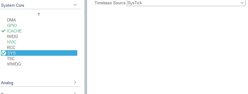

Not sure if it'll make a difference but you don't have debugging enabled.
I've tried on another Nucleo with Debug off and I don't run into errors. I have a counter variable that still counts up and updates in the Expressions. So that is why i say it may not make a difference if you do enable it.
emb_rfAuthor
September 29, 2024
thank you, yes, I also have tried that, but no difference. Still I get the same problem.

I have a lot of Nucleo boards but unfortunately i don't have the one your have. Just out of curiosity, place a breakpoint on SystemClock_Config and MX_GPIO_Init and see if you can get past HAL_Init and SystemClock_Config functions without any errors?
emb_rfAuthor
September 29, 2024
No, unfortunately, it gives the same error.
