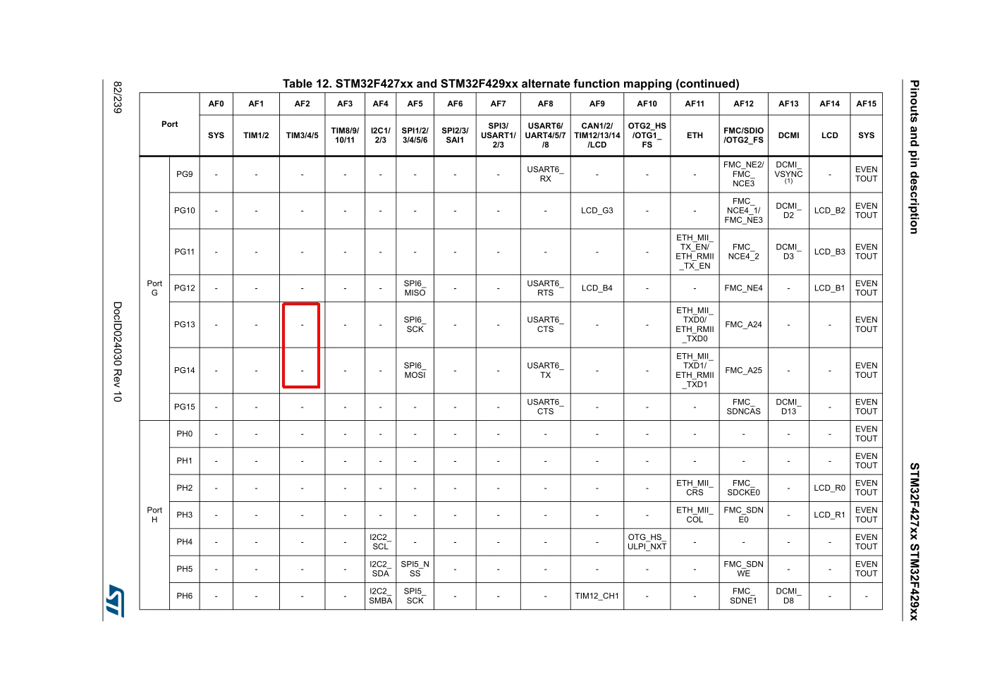

Hi could somebody please help me with this: i am a beginner ,i have set the Timer_init and Gpio_init with bare Metal
i'm working in STM32F429ZIT and i'm aiming to control GPIO pins PG13 and PG14 using the PWM channels with two channel each for every LED
but the LEDs on PG13 and PG14 aren’t blinking
i debugged the Leds, they are working correctly but when it comes to use PWM nothing appears
here's the code :

GPIOG->AFR[1] |= ((0x2 << (4 * (13 - 8))) | (0x2 << (4 * (14 - 8))));

RCC->APB1ENR |= RCC_APB1ENR_TIM4EN;

waclawek.jan
October 9, 2024
PG13 and PG14 are not TIM4_CH1 and TIM4_CH2.
