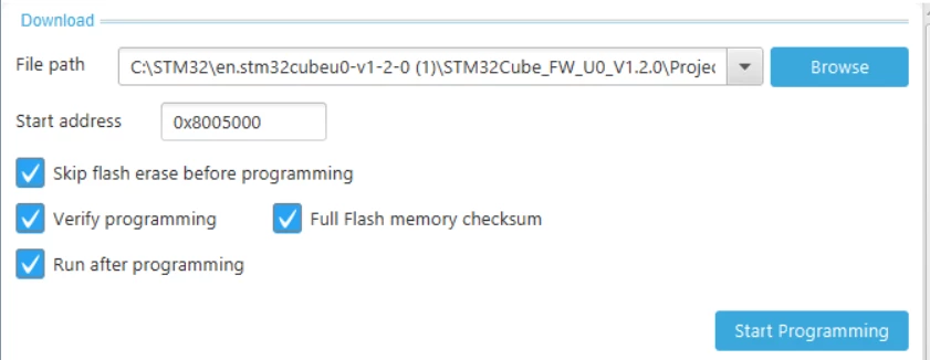

Hi team,
I am using example code GPIO_IOToggle. which is working fine.
1. Tried to use below changes in .ld file as below and that also works fine when we dump code form STMCubeIDE.
MEMORY
 RAM (xrw) : ORIGIN = 0x20000000, LENGTH = 32K
 FLASH (rx) : ORIGIN = 0x8000000, LENGTH = 114K
2. Then tried same with STMCubeProgrammer tool by dumping this binary at 0x8005000 address and run. Here it just keep the LED ON continuously. No toggle done.
MEMORY
 FLASH (rx) : ORIGIN = 0x8005000, LENGTH = 114K
Here is the full .ld file for more reference

The main agenda behind application is to jump to the application using our custom bootloader, and our bootloader also face this same issue of LED suck.
So as STMCubeProgrammer also face the same issue, so our identification is, there must be some issue with the changes in .ld file of GPIO_IOTogggle project which is not done correctly.
Let me know what is missing in this.
Thanks,
Shubham

June 6, 2025
> __disable_irq()
Don't do this without re-enabling interrupts. Program won't work if it uses HAL_Delay.
Tesla DeLorean
Guru
June 6, 2025
Make sure your SystemInit() code sets SCB->VTOR correctly, Or leaves it be if you are doing on the loader side.
Make sure interrupts are ENABLED for them to work.
Do some basic diagnostics/debugging as the WHY it's NOT WORKING
Check vector content, SysTick viable, no it Error_Handler() or HardFault_Handler() spinning silently in a while(1)
