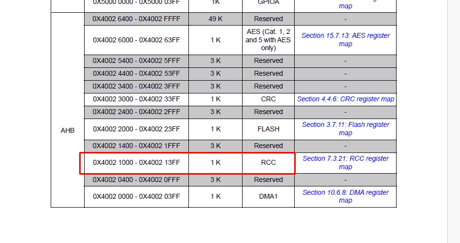

I am trying to turn on the LD3 LED (connected to PB3) on the NUCLEO-L031K6 board using direct register access without libraries, but it is not working. The LED does not turn on. I have configured the pin control register, enabled the GPIOB clock, and set pin PB3 as output, but the LED still does not light up.

waclawek.jan
March 2, 2025
RCC offset to AHB area beginning is not 0x0002'1000 but 0x0000'1000.
Using the CMSIS-mandated device header - as @gbm suggested above - avoids this sort of errors.
kuhicopAuthor
March 2, 2025
I see as 0x0002'1000 in the reference manual
waclawek.jan
March 2, 2025
No, 0x0002'1000 is offset to 0x4000'0000, not offset to AHB area beggining, which already has an offset of 0x0002'0000.
#define PERIPH_BASE (0x40000000UL)
#define AHB_OFFSET (0x00020000UL)
#define AHB_BASE (PERIPH_BASE + AHB_OFFSET)
------> AHB_BASE == 0x4002'0000
#define RCC_OFFSET (0x00021000UL) #define RCC_BASE (AHB_BASE + RCC_OFFSET) -----> RCC_BASE == 0x4004'1000, which is incorrect
