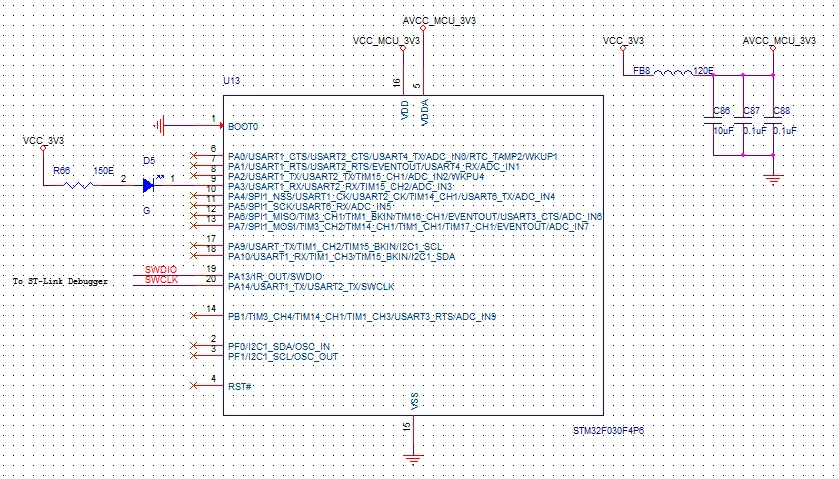

    Best answer by waclawek.jan
    Posted on August 11, 2017 at 13:40
    Yes, but there's no VSSA on the TSSOP20 package.

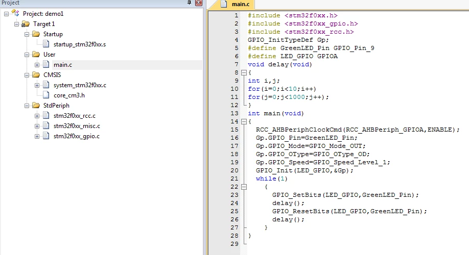

    Devipriya Soundararajan
    August 10, 2017
    Posted on August 10, 2017 at 10:54
    Yes I made a mistake in delay loop. And I have corrected that. Thanks for that.
    Another thing I need to make sure is that, I'm not able to add core_cm3.c file from standard peripheral STM32F0xx library provided by ST. I'm able to add only the header file.
    Is it enough? If not means how to get it?
    August 11, 2017
    Posted on August 11, 2017 at 10:30
    The above is my circuit and program. Hope added all library and everything. But I'm unable to make it work in STM32 MCU. Is there anything need to be done in addition to it?

    Posted on August 11, 2017 at 10:44
    Use volatile for the variables in the loopdelay, so that the compiler does not optimize it out.

    Posted on August 11, 2017 at 11:13
    In addition to that, I'm unable to debug in keil.
    Found error 65: access violation 0x40021000: no read permission
    Will it create issue?
