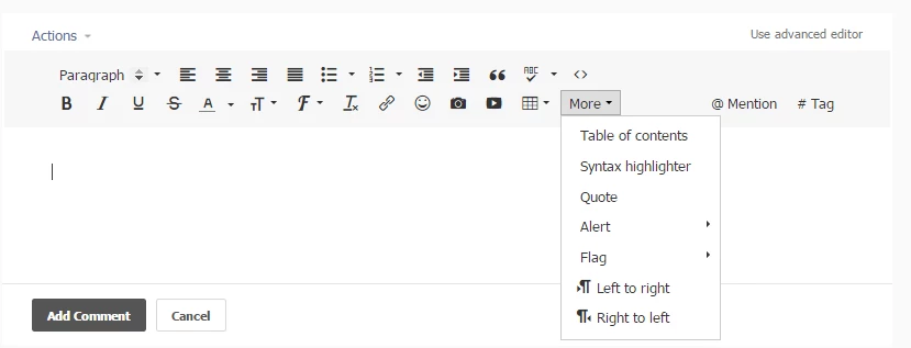

    About
    format source code, y
    ou should expand toolbar by clicking on [
    ] icon :
    Click on ''More >> Syntax Highlighter'' :
    Then, insert your code in the appropriatelanguage:
