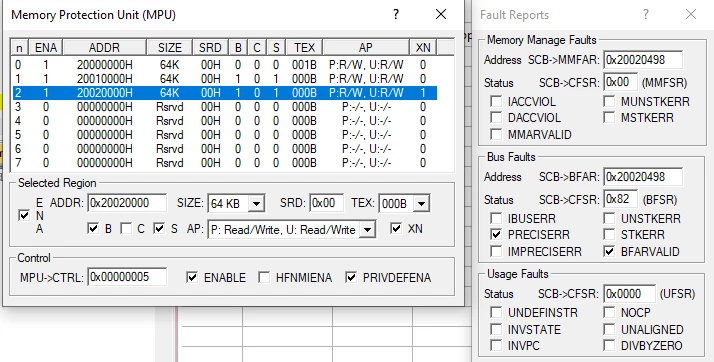

I have just stumbled upon this problem on the STM32F746 and as far as I can tell HardFault only happens if memory is specified in the MPU as shareable, if it is specified as non-shareable HardFault does not occur.
The fault that escalates to HardFault is actually Bus Fault when LDREX tries to access shared memory.
This seems like an unexpected limitation on this device, but it is not mentioned in the errata sheet.

That cannot be the reason since I have set up memory accessed by LDREX as Device memory in this case and according to ST's application note AN4838 to prevent speculative prefetch, memory should be set up as Strongly-Ordered or Device and I tried both combinations but when Shared attribute is set (which should be set for both of these types) LDREX produced hard fault (actually bus fault) as in the picture

I don't think LDREX/STREX to device (or strongly-ordered) memory is supported.
From ARMv7-M ARM A3.4.5 Load-Exclusive and Store-Exclusive usage restrictions:
"LDREX and STREX operations must be performed only on memory with the Normal memory attribute."
milorad
Jan 20, 2022 20:39 UTC
Thanks for that, it does completely explain my findings.
