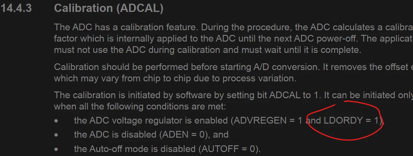

LDORDY bit not found
LDORDY bit does not exist in any registers mentioned in RM0503 rev 2 . I am using ADC1 in STM32U031R6T6 and the code migrated from STM32L010R8T6 is not working .

Hello @KSB
Thank you for reporting this issue. Can you give more precision about your request. For the LDORDY bit that is mentioned on the Calibration (ADCAL) part of the RM0503, but it is not mentioned in any register, I've escalated this internally for investigation and correction if necessary (under internal ticket number 186646).
Best Regards.

Is there any update on this issue?
What is LDORDY? Is it a bit that exists in other families, but not this one?
Or is it a typo for some other flag (maybe ADC_ISR_CCRDY, though it seems to apply to regular conversions, not the calibration)?
